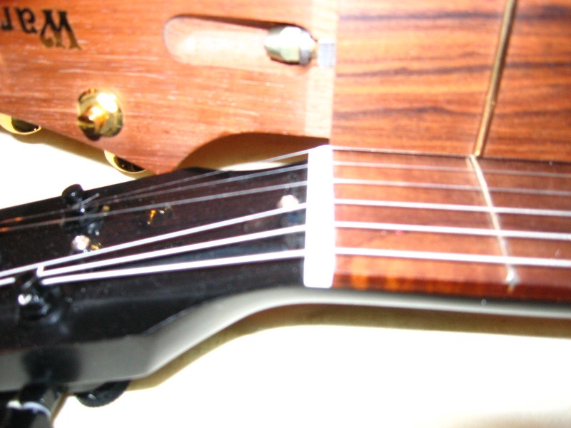

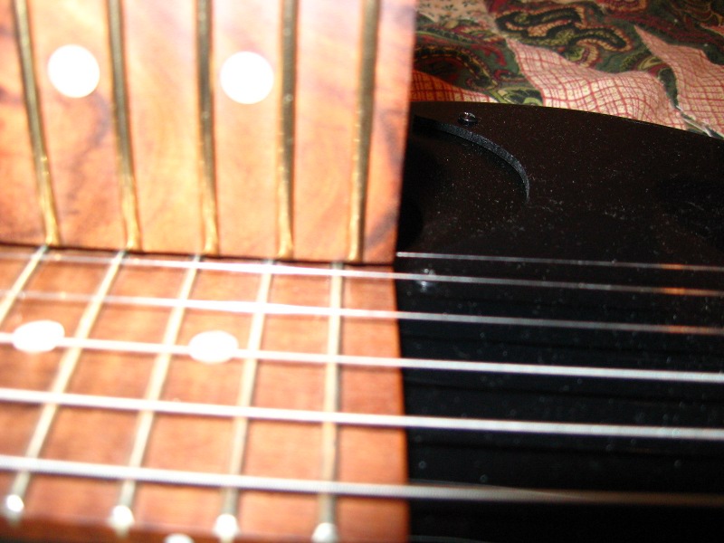

What you say makes sense. For any given scale, the halfway point is at the 12th fret. But I just happen to have a Gibson here and a loose conversion neck. The difference isn't huge, but it's there... about 1/4" or so overall from the front of the nut to the end of the 22nd fret, just going by eye.
So, I held them next to each other, and you can see the frets gradually stretching farther on the conversion neck...
At the nut...
At the 12th fret...
At the 22nd fret
So... wtf? I didn't move the neck for any of those shots - I lined up the fretboards at the nut, and took all three shots.
