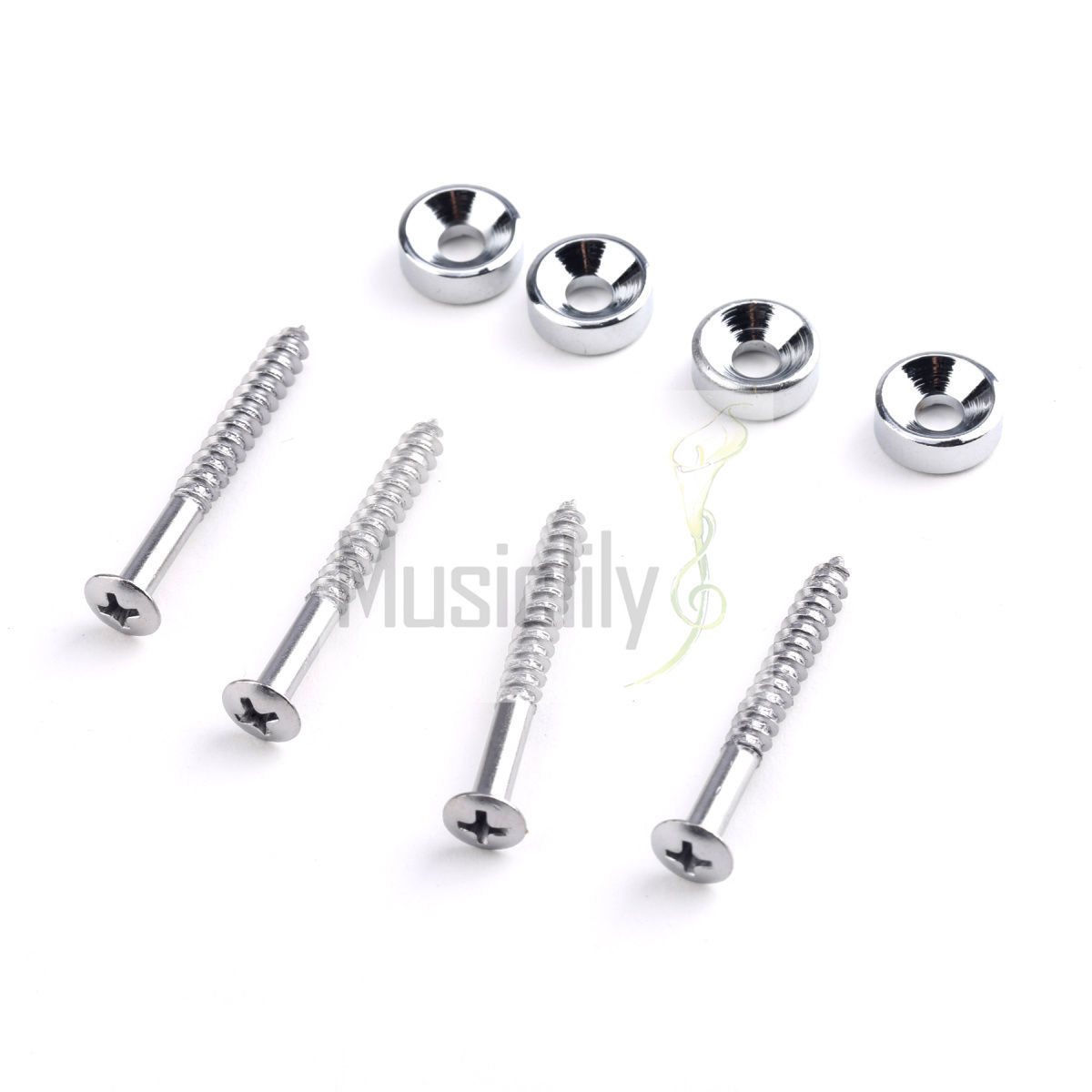

The Anderson neck looks like a good idea, but it's definitely not Fender neck compatible. It's machine screws look about level from the photograph, which would be easy to pull off since they are countersunk. So maybe a good approach for a contoured heel is to omit the neck plate, countersink and install ferrules. This would allow the machine screws to be perfectly square. Although a strong neck plate theoretically makes for a stronger joint, I wonder if it makes any practical difference.

I have a bass that has neck screws and ferrules, very stable. Also, I have had a couple of Ibanez over the years with a similar setup. I think these types of neck joints work very well.

Just for the record, I removed the inserts, dowelled the holes, used standard screws in the same gold as the neck plate and the effect is hugely reduced.
I think main problem was that the countersink head on the machine screws didn't match the profile of the neck plate very well so they didn't seat properly, nor did the colour match help matters - stainless on gold.
It now looks absolutely fine and yes, if you look closely you can see the slight angle, but it's perfectly within reasonable cosmetic compromise and expectations, where previously it was a real eyesore.
