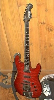

I have an idea to try and create a dual coil version of my beloved Modulus Graphite Blackknife (had it 23 years and the love affair is still going strong). I have searched Warmoth for two days and not found a strat body in H-X-H rear routing though have seen posts here about them and noted four examples in the Strat Customer Gallery. Is that configuration special order only? My plan is to mate up a Moses SK-27 neck, Active EMGs and hopefully something similar in appearance to the 80s Kahler (which is what my Modulus has).
The second question concerns body laminate. Any guesses as to what I'd order to achieve an appearance similar to this picture. The photo is not too good (seems I hold a camera about as well as I play guitar), but the laminate has a beautiful deep scalloped look. I had always thought it was maple but it doesn't match what is showing on Warmoth's laminate pages. Any guesses on what type of laminate this is?
Thanks in advance for any ideas.
Hey ET,
That's a quilt maple top.  You can get the pickup/bridge routes you want added to any unrouted showcase body for free.
Good luck :)
Right under my nose for two days! The un-routed must be the X-X-X listings then. I'm slow I think.
I just went back and looked at the Quilted Maple. I see the resemblance but the scallops are so much smaller, i didn't put the two together.

Thanks Max, I was looking at the finished bodies (though there are none with the right configuration) to determine the appropriate color. The red translucent appeared to be the closest. I've only painted cars and fences so this should be an experience (well, I've done some furniture too ;-)). The s2943 appears to have as large a swirls though requires a TOM bridge. I could sacrifice the Tremelo for that appearance. Price is very good also. The only question will be if the curve of the Moses neck will be compatible. I was just about to send a message off to them to find out.

That's good to know but I just got off the phone with Warmoth and purchased the body. I decided to have them do the finish since this is my first build and I might as well make it easy. Mounting the neck and probable fret work will be plenty of learning for me. Four weeks and it will be here bridge and all, Quilt Maple/Alder in Translucent Red. I'm ordering the neck today too. It's 16 inch radius with 6150 Jumbos.
