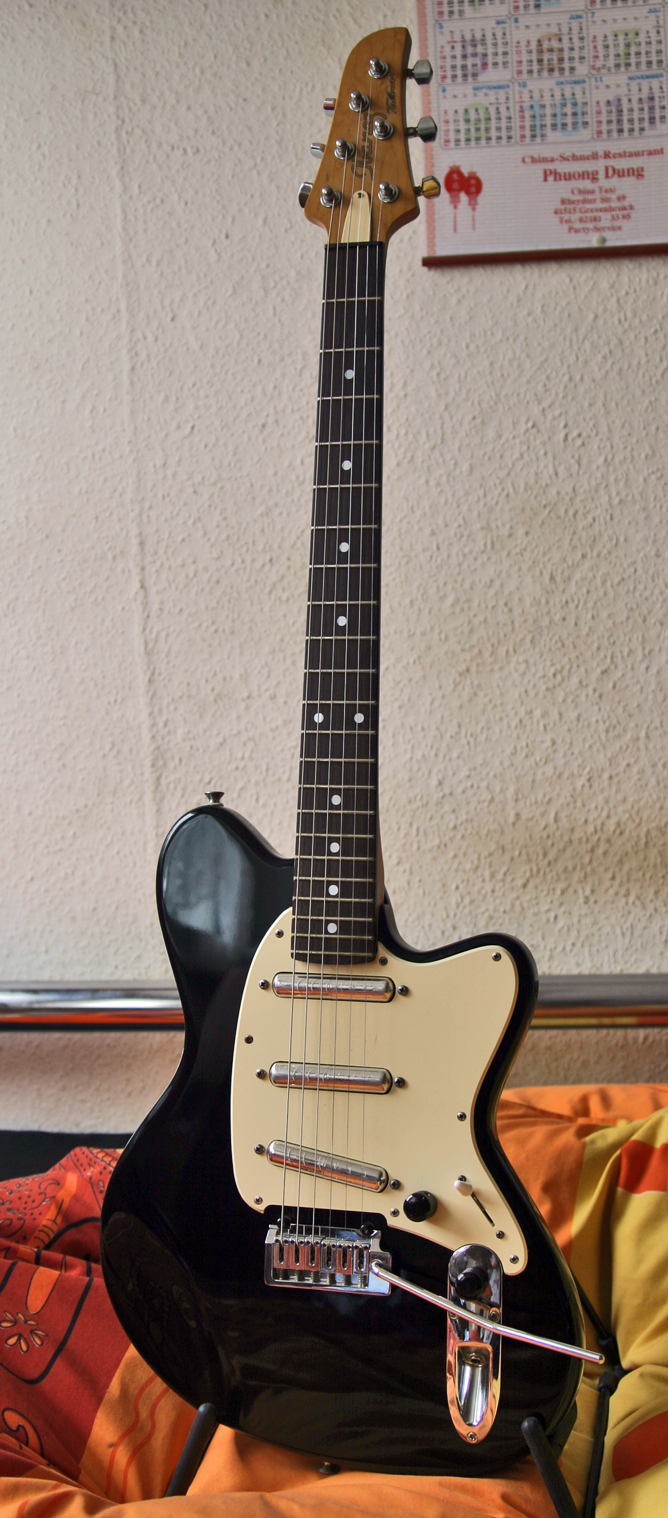

What type of body are you doing??
You may think this sounds kind of dorky, but I was always fond of the Ibanez Talmans of the mid 90's.  I'm always looking for them on ebay but can't ever really see anything I would want to buy used so I'm going to try to make one from scratch (mostly).  A freind of mine has a Talman that has been in its case for ten years or better so I'll be doing most of my measuring off of that one, but changing a few things to make it a little more "mine".  I haven't decided if I'm going to have Warmoth or Doug Darling from Soul Mate Guitars make the neck for me.  Thanks for all the info, I'm just trying to prepare as much as possible ahead of time.
I haven't succeeded at this, but dmraco has. Take his advice over mine!  :icon_thumright:
I like it...would look goot with a WARMOTH Warmoth style neck...
