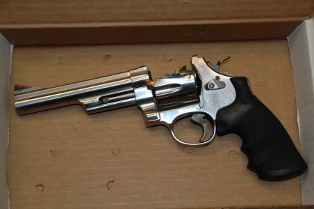

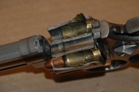

One reason not to buy cheap chinese crap...This .44 mag blew up in a guys face after trying to shoot cheap chinese made ammo...

The gun was a Smith & Wesson, the ammo was the culprit..But still if they invented gun powder and can't make a bullet, then they haven't gotten very far in evolution...

99 times out of 100 when a gun blows up it's not the ammo, it's a bore obstruction. Keep your powder dry and your barrel clean!
That wasn't chinese ammo - it was ammo loaded by the owner of the gun: http://www.snipershide.com/forum/ubbthreads.php?ubb=showflat&Number=1314603 .  One of two things most likely happened here:
1.  the round before this one he missed putting the powder in the shell and the bulletin lodged in the barrel (squib load), then he shot the next round which blew out the top of the cylinder due to the overpressure from the round in the barrel
2.  he double charged the round that blew up the gun creating an overpressure situation.  This is one of the reasons it's suggested to use a powder that will mostly fill the case so that if you do accidentally double charge powder will spill over alerting you to it.
