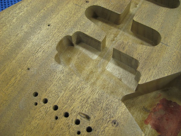

I finally got around to routing out the pickup cavity for a humbucker at the bridge position on a mahogany Strat body I bought some time back, so it was time to start finishing the thing.
You can see how the wood has started aging already by where the wood is fresh cut. I think the thing's over a year old, maybe two, and still raw.

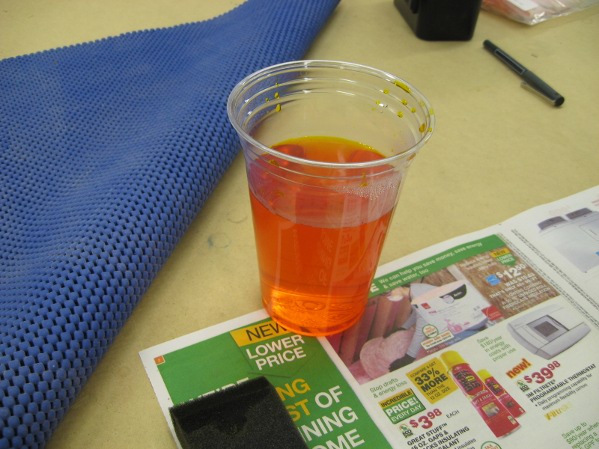

It doesn't take much of it to get the effect. An 8oz bag as shown above is probably a lifetime supply, at least for me. Opinions vary as to how much you need to use, but between a teaspoon and a tablespoon to a cup (8oz) of hot water and you've easily got enough to do 3 or 4 guitars. I put about a tablespoon into about 10oz of water, and this is what it looked like...
Apparently, the stuff is quite toxic and will cause contact dermatitus that's difficult to treat, and is especially hard on the eyes and lungs if any gets in them from the dust or splashing. Cancerous as hell, too. All that fun stuff. So, wear all the appropriate protections (rubber gloves, eye cover, breathing mask, apron, etc.) and watch what you're doing. If you're interested, there's a Material Safety Data Sheet available.
I applied it with one of those cheap sponge "brushes" you can get in 6 packs for about $4. You can see the tip of it to the lower left of the poison in the upper picture. Since it's water-based and goes on kinda thin, it appears to dry pretty quick. With one application, this is what I had after about a half hour...
As usual, it's not as impressive in the picture as it is in real life. But, it's nice. The quality of the grain is preserved in a way that isn't with stains and dyes. I expected it to be more reddish, but it may just be that particular chunk of wood. I'll see what it looks like in the sun tomorrow, once I start with the beauty finish.

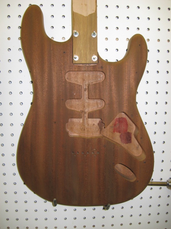

I finally was able to get back to this today. I followed the plan I described earlier with a minor modification. I knocked it back with steel wool, and cleaned it up with a water-dampened pocketless t-shirt shop rag, took some 320 grit after it once it dried and cleaned that up with naptha, but before putting sanding sealer on it I decided I didn't like the way the end grain looked. So, I mixed up some tobacco brown dye w/ 100% alcohol, opened a beer for myself so the guitar wouldn't have to drink alone, and darkened the edges of the thing, just slightly blending it into the front/back like a burst sort of a thing, but not that pronounced...
Is there anything beer can't do?
As it works out, I probably should've added some black to that tobacco brown. Or, maybe just some more brown. Anyway, what little burst effect there was got lost when I put on the sanding sealer...
Isn't that an oogy mess?
...because the raw wood darkened up on its own a bit, diminishing the contrast between the dyed areas and the raw wood. But, I can live with it. Hadn't intended to burst it anyway; that was just a leavening move to even out the end grain appearance.
We'll give it a few hours to harden up, then start punishing it with the sandpaper again and see how things look.
Incidentally, the sanding sealer is brushed on; that's why it looks so ragged. Also, the apparently wild difference in color between these two shots isn't real. It's due to the first shot being in normal shop light (this is a bright shop), and the second one had the camera's internal flash on.

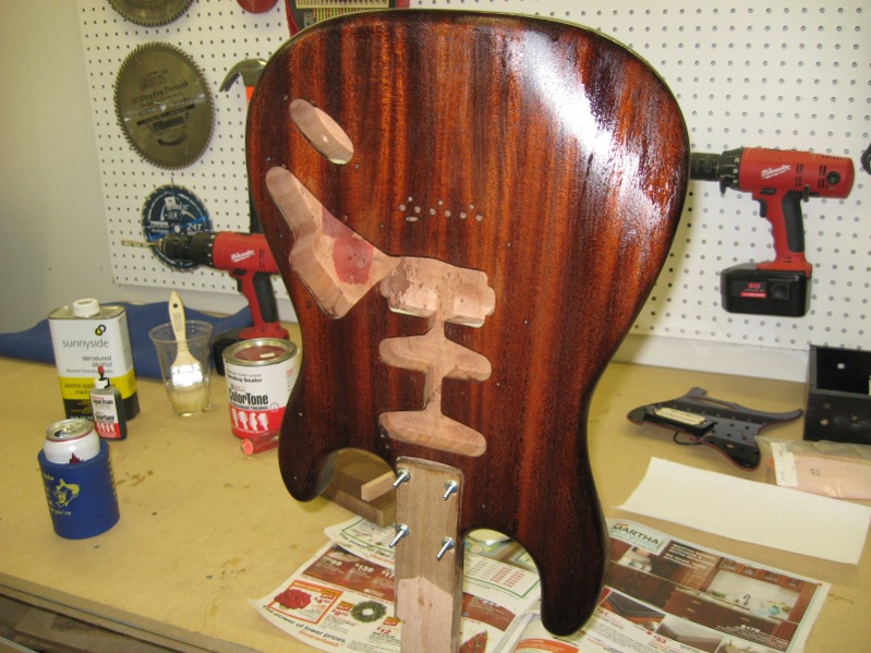

Well, after several false starts, life, and other intervening complications, I finally made some progress on this thing.
The edges aren't as dark as they look in these shots; the camera was getting tricked by the sunlight in the background. They're actually about the shade of coffee. It's a transparent tobacco stain. It's also a bit wider around the edges than I planned, but what the hell. It's still purty. Now comes the waiting until buff/polish.
