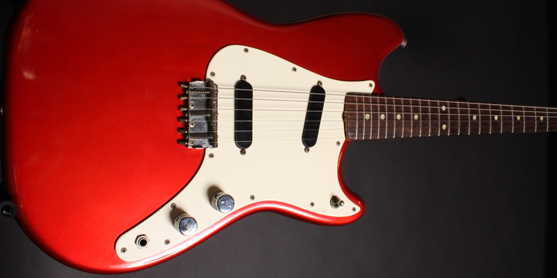

Another suggestion: make it into a Duo-Sonic. Same body, different routing and pickguard.
WD Music sells Duo-Sonic PGs: http://www.wdmusic.com/guards_guitar_fender_duosonic.html
If you do this, you get your toggle switch and don't have to sacrifice your tone knob.
You would have to route out the body for the toggle switch and the wiring of course, but that is a really cool way to go.
Agree 100%. Having the toggle switch there like the DuoSonic would be best, but I don't have the resources to route a cavity into the Mustang body to accommodate that. If you check the Warmoth site, their bodies don't have that option. Hence why I thought just putting it in place of the tone knob might be the best/easiest solve.

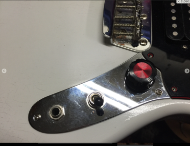

Just to clarify, this is what I meant. I found this online, and the original owner has no idea whether or not the control plate had to be modded to fit the switch.

Judging by looking at my control plate on my Super-Sonic, which is probably the same size as a Mustang plate, it looks like you have to drill the hole to make it slightly bigger to make the switch fit.
Yup, done this to a few Jaguars, '51s and Mustangs. Just enlarge the tone pot hole and use a short-bodied, straight toggle switch. Long-bodied switches and angled switches won't fit. Switchcraft make a very good toggle switch with a short body in either plain metal or brass, and the generic short toggles used by Epiphone will also fit and are available in chrome, gold, and black.
Just be careful with the wiring. Don't solder the wires so any part of them bends downwards or far off to one side. Those control routes can get a bit tight, so you want to keep the wiring running pretty directly.
Also, I suggest you buy at least two control plates, because if you've never enlarged a hole in one before, you will scratch up your first attempt. Do use a proper drill press, if you have access to one.

Wouldn't i be possible to use a metal file to make the hole the proper dimension? A bit more work perhaps, but less prone for it to scratch up.  ???
Yeah, you could just file it, but it'll take much longer, it'll be harder to get an even edge to it, and you'll have to endure the horrible noise for longer!
