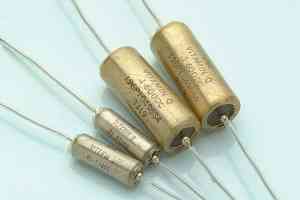

I know. Insane, isn't it? But, they're not the only ones. I've seen where guys will go in the other direction, and opt for more modern caps that are quite expensive. Sprague's "Vitamin Q" caps, for instance...
Very nice caps - oil over paper, aluminum housings with glass/epoxy seals, breakover voltages of 1000vdc+... just wicked parts. Expensive as hell. But, .05µf is .05µf so unless you're guarding a circuit that sees voltages like that, there's no point in using them.
