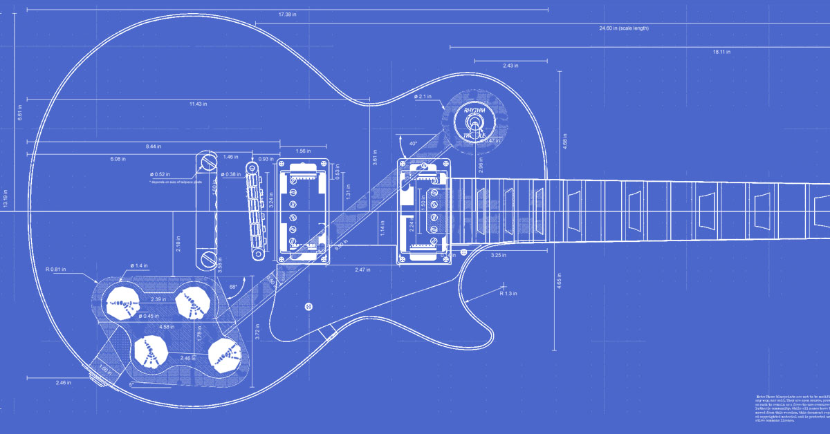

I'm working on my first project not using a precut body but still using pre-routed pickup and neck cutout's of Warmoth's custom body blanks.
I'm the furthest thing from an expert, but it seems like the body blanks are too short for a typical LP shape? I'm seeing body lengths of 17 to 17.5" where the lower portion of the body blank where the neck pocket starts is only 16", and the neck pocked is a bit more recessed from that too.
What makes me feel crazy is that when adjusting the Regal shape to size based on neck pocket width, the Regal also appears to be longer than the body blank, longer than the LP by a fraction of an inch. Perhaps it uses a different starting material? Or am I just really bad at measuring?
Thank you!
First question: what plan are you following?
I used measurements from my Les Paul classic body and then used the pdf for the body outline from Electric Herald, scaled to size, to mock it up against the W routed body blank measurements.
My goal is to make a double cut LP, so I was going to mirror the smaller horn sides on the top to start.
