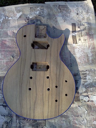

Masked off the binding and laid on a few coats of Behlen vinyl sealer.  I'm liking the look of this wood and wondering if I want to put much color on it now.
Actually, that's where most people end up. BK is a very attractive wood on its own, so you don't see many tinted finishes on it.
I tinted mine because everybody+dog does clear finishes on Limba, so I wanted something different. And guess what? It's still an attractive wood. But, mine didn't have the natural color streaks in it that yours does and you may want to show those off. Plus, those different-colored streaks may have a detrimental effect on any color you might apply.

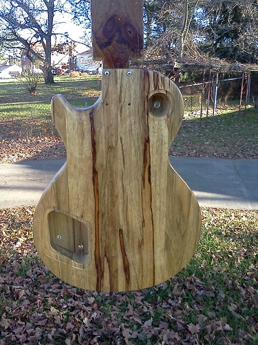

Is it just me, or do a lot of the BK bodies showing up in the showcase have more interesting/attractive grain on the back instead of the front?
It may be you, but it's more likely just what's been in the Showcase lately. I've seen a lotta BK bodies with stunning tops. I'm not gonna look 'em up, but I suspect if you went through the Gallery or the completed builds section of the forum, you'd see 'em too.
To be fair, they do seem to come in batches. Earlier this year, it seemed like everybody was putting together something with one of those bodies, and they were all nice. Now, you're not seeing many. Probably depends on what Warmoth's buyers find on their searches for exotic woods and their curing schedules. Fall into a deal on Ziricote, and a year later there are a pile of those necks up for sale.

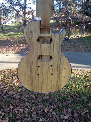

I don't know that I'd put any color on that, DEFINITELY not the back any way; maybe do the red on the top and leave the back clear?
That's the way I'm leaning right now.  Maybe a burst to clear on the back.  I'd love it if the top turned out like Cagey's though.  Maybe just a little more transparent.

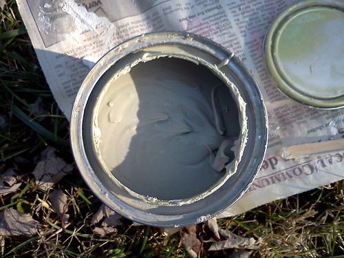

After several good coats of sealer I've been grain filling with neutral Behlen Pore-O-Pac grain filler.  I started by stirring it to a nice pasty consistency (which took way longer than I would have imagined).

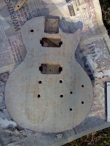

Once it hazed over I squeegeed it at an angle to the grain and rubbed it down with a coarse shop rag.
IMG_20121201_135721 by scuffcakes, on Flickr
This was fill number 2 and I'm planning on 2 more passes at it just to be sure (waiting a day in-between each time).  Does anyone see an problem with this method?  I can see the filler in the pores and the wood feels much smoother.  I can still see/feel just a tiny amount of texture in some areas.  Any tips or corrections are appreciated.
You're doing fine. Some woods require more than one or two passes with the filler. I remember when I did my Mahogany Strat, I thought grain filling was going to become a second career.
