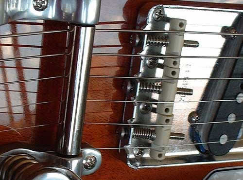

I'm planning on a Thinline project. Bigsby B5 with plate, I'm just wondering what Bridge routing option I should take since I can't find the Jazzmaster style bridge.
regular tele bridge, with little cutouts for the strings....
Thanks, I have seen this in the past, and I did think that it looked cool... at the time. The plate that I was referring to was the one that has the jazzmaster style tune-o-matic and comes with the $200 B5 kit (source: musiciansfriend.com). Also, the standard tele (as well as vintage) bridge route are string through body, which I would like to avoid. Would it be best to just order it without any routing and do it myself, or is there a hardtail with the same measurements?
A telecaster bridge doesn't get routed, it is mounted on top of the body.  There is a rout for the pickup, and the string holes.  They will omit the string holes for you.  They will probably charge you an extra $15, but in this instance it's probably worth it.
