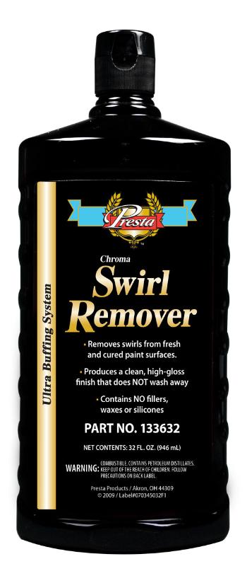

the gloss won't really ever get up to a factory-applied and machine-buffed look unless you kill yourself to get there (i.e., expend tons of elbow grease, or get your hands on a decent quality buffer yourself).
OR if you used some of this for your final pass. available online or any decent auto supply shop, and one bottle will last you the lifetime of the average hobbyist / builder.
I have used it on poly, nitro, tru oil, reviving plastic pickguards, you name it....
Oh, and it is also silicon free
http://www.prestaproducts.com/Swirl_Remover-details.aspx
