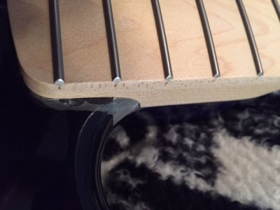

I had a local guitar shop paint my bass guitar. It looks great, but I made a mistake when putting the neck in. The joint was too tight because of some paint overlap, so I sanded the pocket and put the neck in. As you can see, I didn't sand it enough and there is some chipping and discoloration. Is there a way to fix this? I believe he used nitrocellulose, but I need to double-check to make sure.
