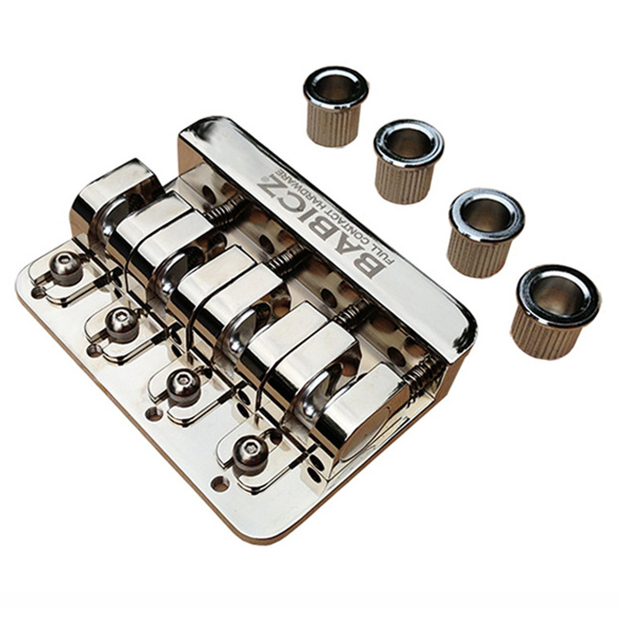

Are you sold on the string thru?  If so then I think the only Warmoth rout you could do (on a 4 string bass) is the 2Tek.  I've built several basses with the standard Fender 5-screw (Gotoh 201) routs.  I've used the Babicz FCH bridges to date, although I'm thinking they might have a bit of an intonation issue.  I'm trying a Hipshot KickAss on my newest.  They both use the standard Gotoh rout.
Although I don't think that Warmoth can rout for the string thru, Babicz does make a string thru option.  They use the Gotoh 201 screw routs.

No the Kickass does not mount on a Badass III rout.  The Badass uses three screw mounts and the Kickass the more typical 5.
That means the Kickass needs a standard Fender mount which is similar to the rout Warmoth does for the Gotoh 201 for classic P and J style mounts.
