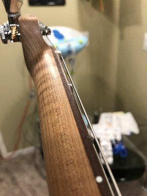

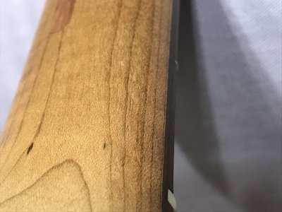

I have an unfinished (burnished) roasted maple neck on my warmoth Tele. 95% of the neck length feels great. Feels like silk boxers lol. I noticed a couple spots up near the first couple frets where I could feel some rough spots. I thought it was an area where I didn't burnish it evenly. On closer inspection (bright light at the proper angle) I can tell it is actually some light scratches that I feel. I don't ever recall doing anything that could have scratched it.
Question - is there any way to fix this? The obvious answer is to sand it a bit but I don't want to change my neck profile...I love the way it feels/plays.
Would a tru oil/gun stock wax finish help this at all? I know I'd lose my "raw" feeling but these scratches are driving me nuts.
Thanks!
Couple pictures of the issue (hard to catch on camera). Also I think I discovered how the small scratches got there - when I removed the guitar from my wall hanger I noticed the neck tends to bump against the plastic part on the front of the hanger. I've probably been causing these over time :(
Any tips or suggestions would be greatly appreciated!

I'm not sure I can tell where the scratches are. Is it three lines slightly above the first fret? Those would definitely be something I just live with.
Are they actually scratches, or dents? If the latter, it might be worth trying to steam them out.
It is really hard to see in the image :( Help up in the light at an angle it looks a lot worse than this.
They are more super shallow dents than scratches. Just kind of scratch shaped. I'm pretty sure I caused it but dragging the neck against the plastic at the tip of my wall hanger when removing it to play.
