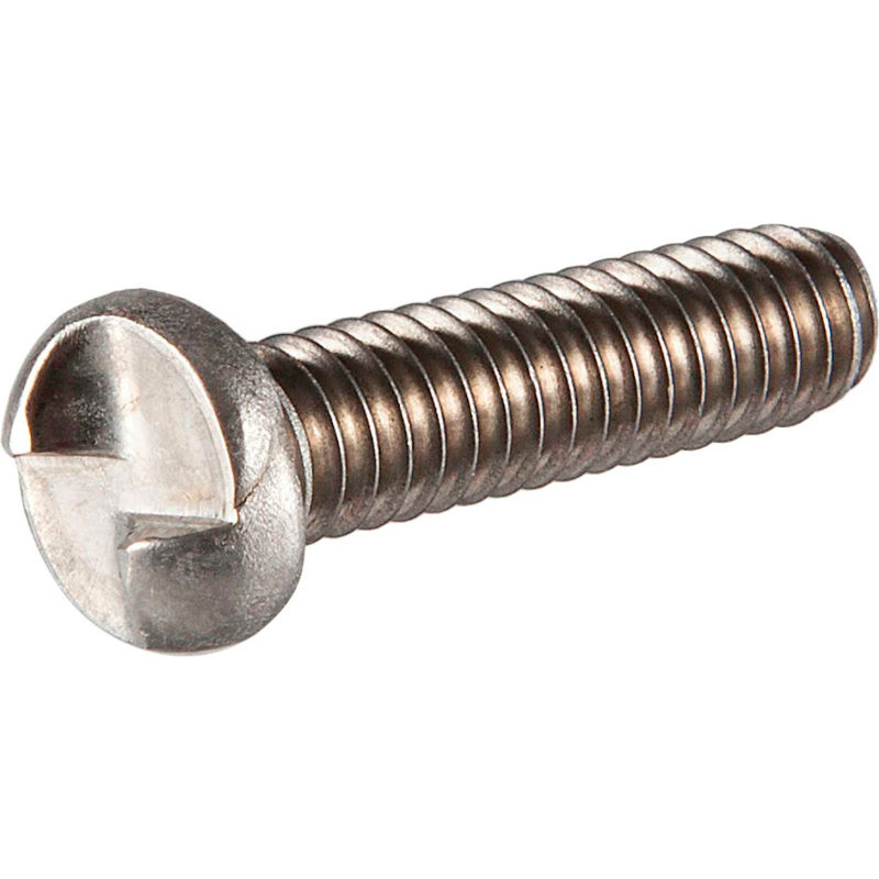

After a few decades of incessant monkeying with guitars I'm convinced they should use something like this:
