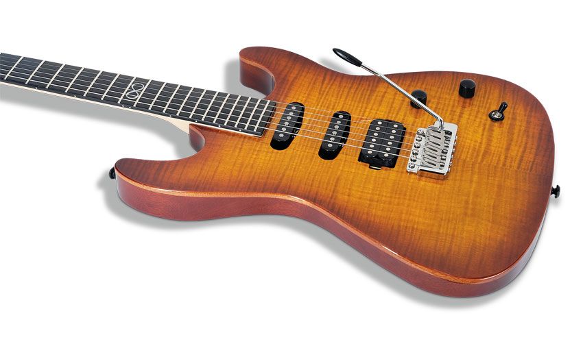

Check out the control configuration on the original Chapman ML-1.  It had an HSS pickup configuration, but a Volume/Tone/3-way toggle.  The tone pot was a push-pull and the controls worked like this:
Tone Pot Down
1 - Bridge HB
2 - Bridge HB + Neck SC
3 - Neck SC
Tone Pot Up
1- Split HB + Middle SC
2 - All 3 pickups
3 - Neck SC + Middle SC

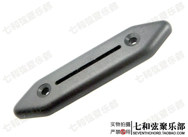

Or, since I recently found (and bought) some bezels for 5 way blade switches, I can install one of those after all.
Someday, I'll make up my mind  :laughing7:
Nice find Kevin, many's the time I could have used one if these. Is 41mm the standard distance, center-to-center, for the mounting holes on these switches? I suppose I could measure one, but lazy is as lazy does.....
Oh well, felt bad about asking when I had a switch AND a digital caliper sitting in my parts cabinet. To answer my own question: Yes, 41mm, center-to-center, at least on the one I had lying there. Now, whether or not that's standard for all, I can only guess it to be so.  :icon_scratch:
These would really be cool in chrome.
I can't measure those bezels as they're buried in storage at the moment, but I do remember having the same question when I ordered them and not being able to get an answer easily (it's a Chinese supplier). Fortunately, they're very inexpensive (and as a side note, the only place I've ever seen them for sale) so I just took a flyer. Once I got them, I mated one up to a switch and it fit. So, whatever the dimension is, it's right for a standard 5-position blade switch.
Normally I wouldn't have need of such things, but if you have to cut a slot in a finished body, it's probably somewhere near impossible to do and have clean edges. In that case, these are just the thing. Any finish chips or cut irregularities would be covered up.
What remains to be seen is how well one works installed. Between the thickness of a body top and the bezel itself, the far throws of the switch may be interfered with by the bezel.
....if you have to cut a slot in a finished body, it's probably somewhere near impossible to do and have clean edges.
Ain't that the truth! Bezels are like molding: They can cover a multitude of sins!  :icon_thumright:

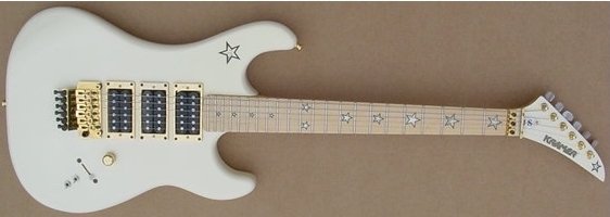

It's a little bit of a pain to cut, but I really like the Kramer Richie Sambora/Jersey Star way of using a 5-way. It's out of the way of your hand and the 'backwards' pickup order (bridge pickup is nearest the ground; yank it backwards, toward the bridge, to select the neck pickup) actually makes a lot of sense once you use it. (Slamming it forward for maximum power, bringing it back for calmer, smoother tones.) See attached image.
Otherwise, a 3-way toggle with one or two push-pulls to facilitate other options is what I'd go with. An S-1 switch or plain mini toggles also work fine. Rotary switches are a pain in the arse in every regard. There's a good reason why PRS have stopped using them for most models and they're rarely used by other companies except by Gibson/Epiphone with chicken knobs (the only knob that makes them easy to operate) for vari-tone circuits.
