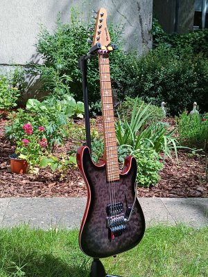

I also ordered a tremcover in black/red/black.
I found this to be a project, where mixed color hardware would look good, so everything touching the red paint is black, everything else is chrome except for a few details in anodized red.
- Tuners are Gotoh Magnum lock.
- Pickup is a Seymour Duncan '78 Model wired with a 500k pot.
- The trem is a Schaller Lockmeister: I didn't like the thought of ordering an Original Floyd Rose from the USA, when it's made here in germany anyway. Also the Schaller was less expensive here and I could order it with a 16 inch (brigde) radius and a 10 inch radius R3 nut.
- Since the guitar is already tuned to D the EVH D-Tuna is really a "C-Tuna
- I had a hard time finding a trem stopper, so I had a colleage make me one! He nailed it!
Warmoth really nailed that off-menu paintjob. I mean; it's absolutely needless to say, that this guitar was meant to play a huge variety of styles. (Aaron plays a Van Halen Riff)
But I seriously didn't plan to let the color scheme reflect that, I just always loved the combination of black & red! :ROFLMAO: But now it does and I like that as a nod to Eddie.

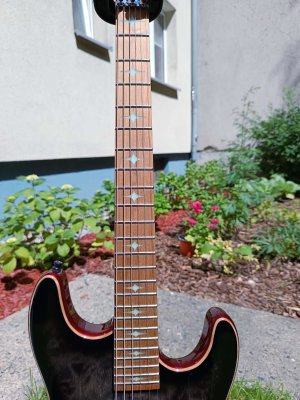

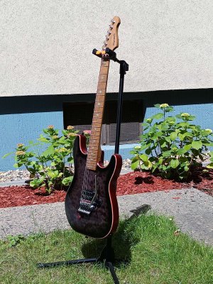

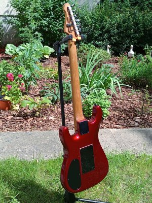

View attachment 65359View attachment 65360View attachment 65361

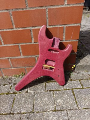

I started planing this in February 2024, gave it a lot of thought, watched a lot of Aarons videos and exchanged emails with a couple Warmoth employees and then this is what I ordered:
7/8 S-Style Guitar Body
Construction:
Solid
Core Wood: Basswood
Lam Top Wood: Quilt Maple
Right / Left Handed: Right-Handed
Control Cavity: Rear Rout
Neck Pickup Rout: None
Middle Pickup Rout: None
Bridge Pickup Rout: Humbucker (Wood Mount)
Controls: Volume 1
Jack Rout: 7/8" (22mm) Side Jack Hole
Bridge Rout Type: Tremolo
Bridge Rout: Floyd Rose (Angled Pocket)
Install bridge studs?: No
Mounting Holes: Standard 4-Bolt
Neck Pocket Shape: Strat®
Body Contours: Forearm Contour, Tummy Cut, Custom Contoured Heel
Binding and Edge Decorations: Natural Masked Edges
Battery Box: None
Paint Category: Dye
Top Color: Black Dye
Back Color: **Candy Red** (Off Menu)
Satin or Gloss: Gloss
Custom:
No Return/Refund/Cancel due to the off-menu nature (Off Menu)

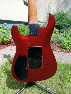

View attachment 65349View attachment 65350

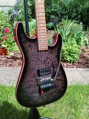

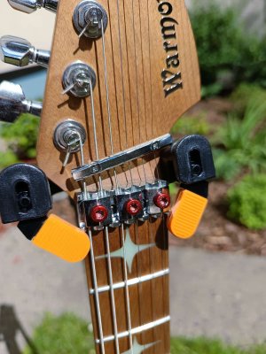

View attachment 65351View attachment 65352View attachment 65353

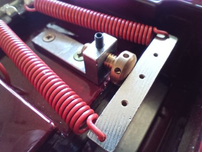

Finally, this is what it looks like on me, I love that it makes me look taller! :ROFLMAO:
And it sounds and plays awesome, at least 78 7/8 times better than every guitar I owned before!
That turned out great! I really appreciate your attention to detail. Thanks for sharing all the terrific pics + info.
Super nice! How do you like the ‘78 model?
Strangely, in the beginning I found it way too soft and I - pls don't hit me - even changed the magnet for a while. But not for long, it's back to factory specs and I love it, it's really fun to do squeals and pinch harmonics.
Don't understand why I didn't like it from the start! :ROFLMAO:
Awesome build, never would have thought to do a Candy Red.
The off menu thing is so funny to me… I’d be more inclined to buy that as a return from the showcase than any of the green burst colors. Besides, I can’t be the only one that throws out all of those little warning papers and immediately shreds open the packaging on Warmoth delivery day!
