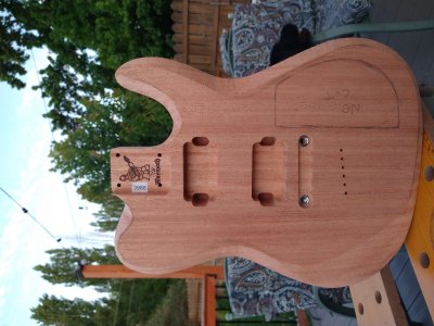

"Finally" got the neck and body that I ordered on April 10!  (It was almost exactly when predicted, but felt like forever!)
7/8 Tele Neck and Body - both Mahogany
Boatneck Warhead with SS frets
Body rear-routed for humbuckers with a recessed TOM bridge.
Will post pictures as I get going on it.
I started rough carving on it last night. Planning to finish similar to a cherry SG.

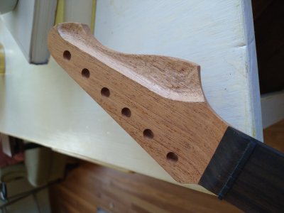

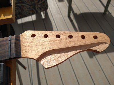

Did a little carving on the warhead headstock to add a little interest.  Roughed out with Dremel then used small carving knives.  First time I have tried that.  Pretty happy with the vibe!

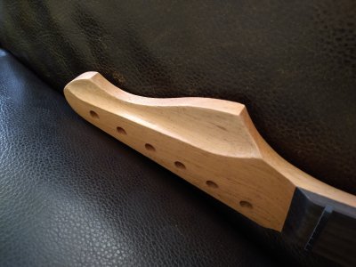

One more.  Buffed it with maroon Scotch Brite until the carve has a nice driftwood sheen.

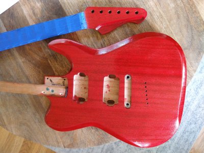

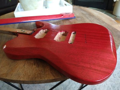

A few finish updates.  Layers red tinted tru-oil.

Just about got this one whipped.  Waiting on knobs to arrive this week, but otherwise this one has come together and is playing beautifully!  Will pay some pics when I get it done.
