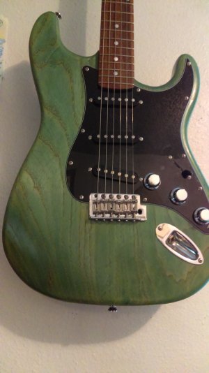

I am not sure this will help, but I used Keda dye on my guitar body and 10 coats of tru-oil. It worked out beautifully. (Keda dye is a concentrated powder you can mix with water.)
