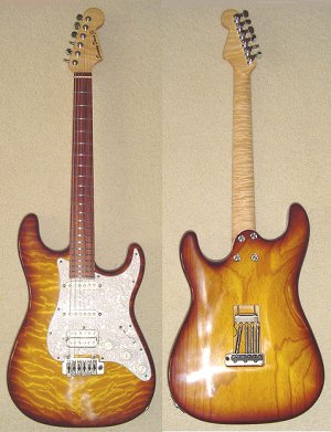

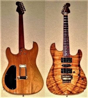

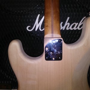

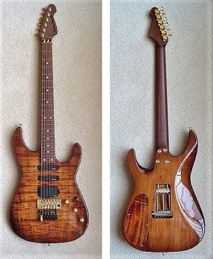

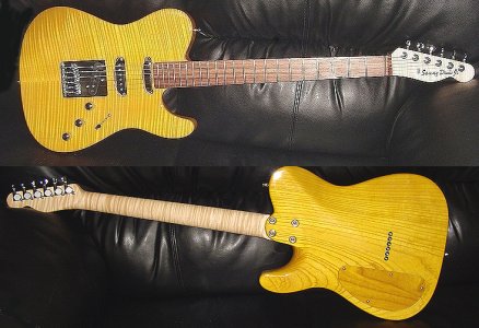

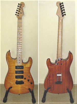

Hi guys,
I haven't logged onto this forum in ages, but I've been building Warmoths regularly, with my total count being over 20 builds now.
A member sent me an e-mail asking about an old post & more info of my contoured heels, so I decided to log back on & post some pics.
The thing that has me wondering is why Warmoth doesn't offers a contoured heel option.
It would be very easy to program into a CNC machine & charge an extra $50.
I've been buying the bodies raw, contouring the heels, painting them etc. & it's a tedious job.
If Warmoth offered this option, I'd choose them to paint the body as well, which would mean more $$$ for them, less hassle for customers & an option that lots of people would love.
Btw, it's nice to be back on the forum. No idea why I stopped posting & kept building. 🤷

Really well done, thanks for sharing.
Have to agree, I'd have a few Soloists already if they could do an AANJ styled heel. I did see a couple of years ago (40th anniversary post) that they had done one, but nothing eventuated.
Perhaps they'll get on it soon :)

I just do the Fender contoured heel (except for my most recent Soloist) and use the Vintage-Modern neck.
Would be convenient if Warmoth offered that while expressing that it cannot be used with the Modern neck construction.

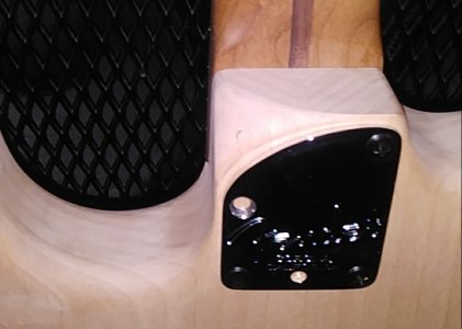

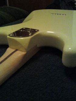

'Just did this a few minutes ago. My third one (I'm not a pro).
I would also like to add regarding Fender's contoured heel -- not the new one (which is also very cool), but the one they've offered for over 20 years; after looking at many photos online, I am convinced that they are all carved by hand rather than on the CNC.
I draw this conclusion because of so much variation from one guitar to the next. They would all be 100% identical if they were part of the CNC carving process, but they're not. I use the Jeff Beck signature model as my reference for carving my own.

While it's true that you would need to finish/paint or have the guitar finished/painted yourself, there are not a lot of tools required for the Deluxe (now called the American Professional II) contoured heel like that in my photo. I used a sharp chisel to get the basic carve, and then a sanding block with 220 grit sand paper, then a final sand with 320. It takes only a half-hour. Of course getting in a hurry is the worst thing you can do. I also have Warmoth dowel & fill the unused (which is also the index) hole. No need to order without any holes. I have now carved 3 of these successfully, and I am not a wood worker. It's just really basic if you have a good eye and can copy what you see in a photograph.
