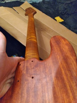

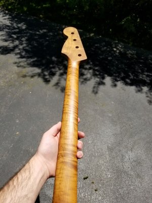

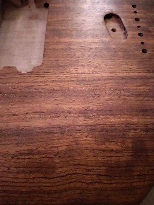

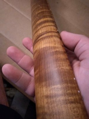

In my excitement I've decided to begin prepping the body/neck finish. So far I've sanded each piece with 220, 400, 600, 800 then 1000. I didn't want to get into the super glossy territory and cause the neck to gain any stick-tion. The colors and grains have darkened quite nicely and I'm very excited for what's to come.

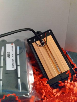

I was a tad worried the 24 Fret overhang and the use of two Musicman Humbuckers would cause interference, but we're in there like swimwear!

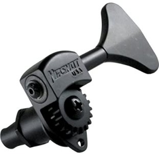

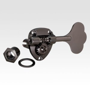

Also any thoughts on each Tuner I've posted?
Looking at Gotoh or Hipshot Ultralite. Trying to find the best 14mm Black Clover tuners.. I would prefer them to have a flatback vintage style, but I don't think I can get that with clovers to fit a 14MM rout.

I like the look of the Gotoh personally, any particular reason you went for a 14mm bore?
No particular reason beyond having the ability to oversize them myself IF I had to... figured I could cut more material out but never put it back. That said, not exactly looking to rout them out further right away. Maybe if compelled in the future.
I don't know about the route size but hipshot makes a key like the gotoh

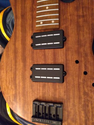

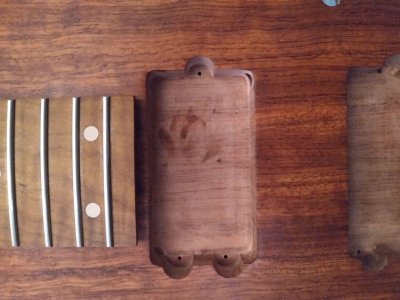

I got the pickups in and went ahead and mocked them up. I wasn't initially a fan of the 24 fret overhang as I thought it threw off the overall Fender Shape, but after adding pickups (and their vertical blade style magnets) I'm loving the continuation of the vertical lines thematically.

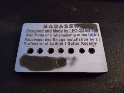

I lapped the bridge, not that this is needed or even recommended but because I was bored and had leftover sandpaper on my desk.

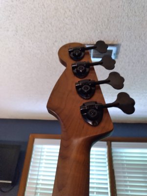

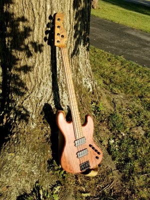

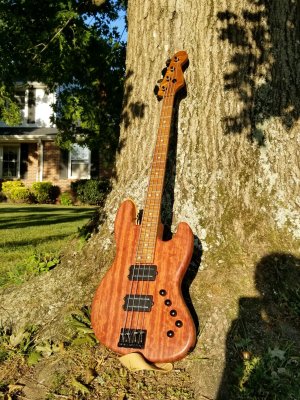

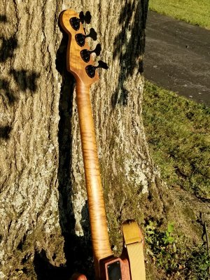

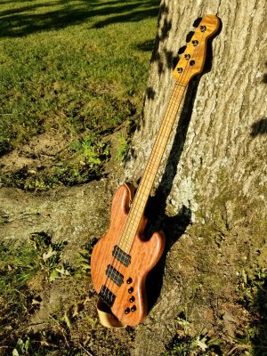

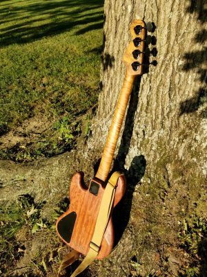

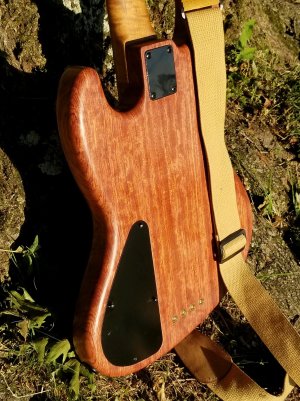

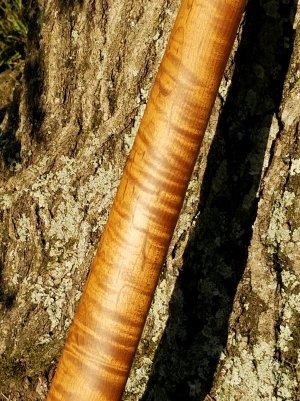

We did it boys. I've been too busy playing to take actual pictures, but I found myself arriving home today with a little sunlight. Also a little roasted maple-porn.
I came to these forums a total nub, but the guides showed me the way. I've still got a few screws to replace (was overzealous with the screwdriver) but I'm thinking this one's about whipped... now to shop for a case.
