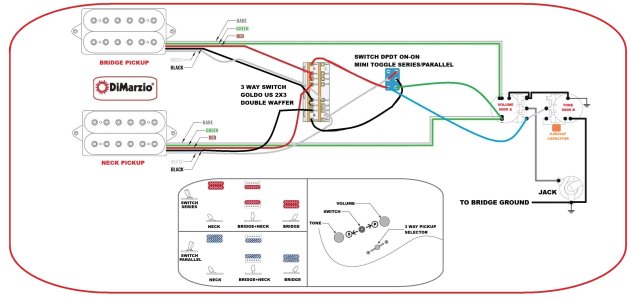

C CROALEX Newbie Messages 4 Jan 11, 2026 #8 Hello,nobody to make this wiring diagram... I create one differentwith my favorite sounds with 2 humbuckers tell me if it's ok? Alexandre Attachments 1.jpg 334.1 KB · Views: 11
stratamania Mythical Status Messages 12,456 Jan 11, 2026 #9 You really need a 4PDT switch to do what you are intending.

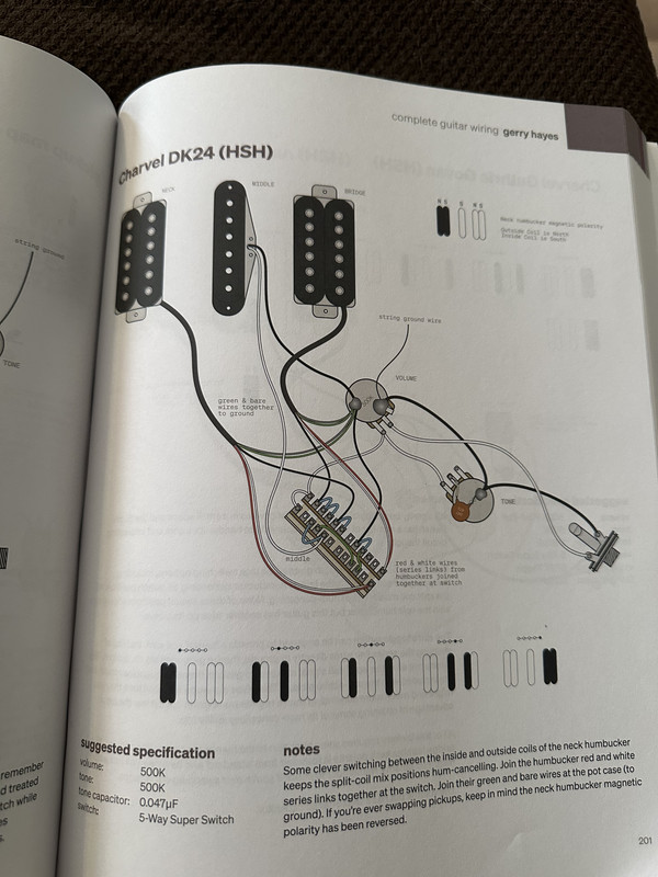

H HumanisHappy Junior Member Messages 99 Jan 11, 2026 #10 Are you wanting whatever that Charvel wiring is? I think I have it in the book at home. Will check Edit Last edited: Jan 11, 2026
