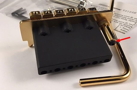

Hey there,
On the bottom of the gizmo / hole that accepts the trem arm there's a hex bolt. (see attached)
Does anyone know what that hex bolt actually does?
My hope is that maybe it allows adjustment of where the arm stops at the top of it's tightening,
but I don't want to mess with it until sure.
Thank you!

It is for adjustment of the tremolo arm tension. In other words it adjusts how freely or otherwise the arm rotates dependent on personal taste.
Humm ... That bottom bolt 'seems to be' totally tightened, as in all the way in,
and yet if I loosen the much smaller collar adjustment screw that is right below where the arm is inserted, the arm will flop totally loose.
Does that bottom bolt need to be backed out to tighten the rotation of the arm?

Sorry, I was referring to the collar adjustment screw which is what I thought you were asking about. I would leave the bottom bolt as it is. It is part of how the mechanism is held together. Loosening it would just increase the mechanism possibly being able to flop around. This bolt may have been added to prevent that as the earlier ones may not have had it and could sometimes be prone to flop or wobble.

Have you got a photo of the bottom of it Steve?
I found this Wilkinson VS100 https://g-gotoh.com/product/vs100n/?lang=en where I could see it. It seems to be referred to as a stud bolt. Perhaps it is also adjustable, one way to find out and can always be tightened again if it is not.

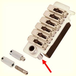

Also, after some more visual inspection I'm seeing a knurled nut on the bottom of the main plate that holds the arm socket in place.
I suspect that if I want to change the final stopping place for the arm, i.e. the place where it is fully tight and will go no further,
it might be to loosen that nut and turn the whole socket and re-tighten, but maybe ... just maybe ... if I'm lucky ...
that hex bolt at the bottom of the socket is actually a quicker adjustment for that final position.
Think of it in a similar was as the  main truss rod adjustment and the quick side adjustment.
I also found a better photo showing the hex bolt.
