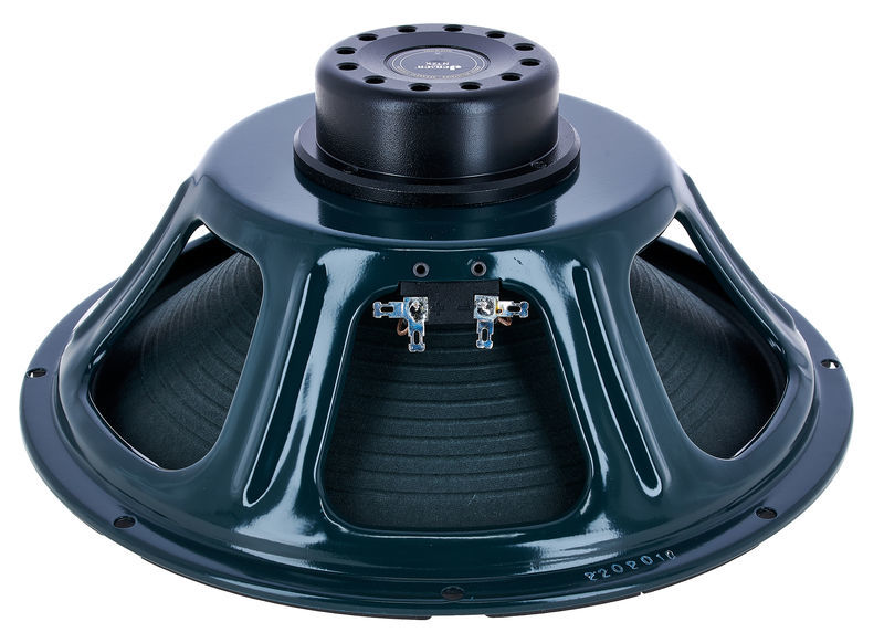

I've always been a big fan of the eminence GB12.  In your price range as well...
What do you like about that loudspeaker, Trevor?  I have a cheap-@ss Vox 1x12 cab I'm using with my Carvin V3M and it sounds...okay, I guess.  I'm contemplating swapping out the loudspeaker and I'd welcome your input, since I like the way your stuff sounds when I hear it, and I know you're very capable of discussing characteristics in clear, concrete terms.
What I like best is that it is a very natural sounding speaker.  That is, no one frequency is exaggerated over any other.  It also sounds good overdriven.  Not a lot of overdrive harshness that you'd get out of, say, a Jensen or something like that.  Works great to my ears.
It's an older design (like over 20 years old), and from what I gather it is Eminence's take on a older Celestion greenback.

Wasn't quite happy with the sound, so I got a Jensen P12R. That's a 25 watt with an alnico magnet.
I swapped one of the Celestions for this Jensen and the difference was mindboggling.
Not only did the Jensen sound good, but it also showed that the Celestion sounded really bad. As in the sound didn't "come out" of the cabinet. I have no other way to describe it. The Jensen sounded good as one would expect but when I moved my head in front of the cabinet's grillcloth between the two there was an almost psychoacoustic effect of the sound from the Celestion that to me sounded like it couldn't quite travel out of the cabinet, but sounded more like it was "stuck" in it.
The effect was so dramatic that I decided immediately that I wanted to replace the last Celsetion still left in the cabinet.
So I got another Jensen.
But this time I thought I wanted to try another model and got the Jensen N12K, a more modern speaker with a neodymium magnet.
And this one - to me - sounded even better. :icon_thumright:
