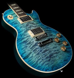

2) i would like a quilt, deep rich blue top

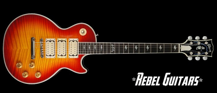

i will try and post a pick of what i am talking about
8) on the neck i would like custom mother of pearl inlay of lightning bolts

From your list, the only thing I see that Warmoth does not currently do is the lighting bolt inlays.
