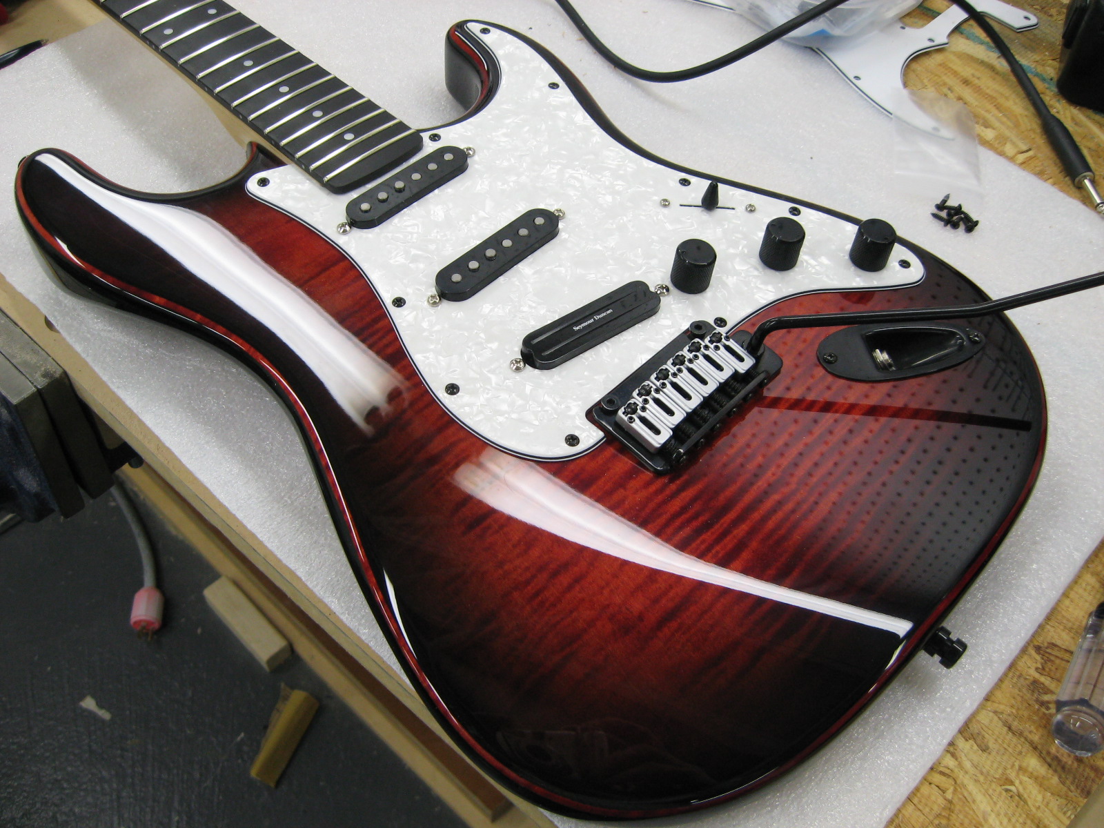

That Koa must be awfully heavy stuff. I have a chambered swamp ash/curly maple Strat body and I don't think it's much more than 3 pounds unassembled. The whole guitar once finished only weighs 7lbs 4oz. Anyway, I put a maple/ebony neck on it, and there's definitely no tendency to dive.
If your body is really that heavy, you'd almost have to put a bass neck on it before you'd have to worry about it diving on you. As it is, once assembled, you might be looking at a 10 pound guitar.

Is that a pro or vintage neck on that beautiful guitar of yours?

It's a Warmoth Pro ebony on birdseye maple neck with stainless steel 6100 frets and vintage tint gloss finish on it. It's a wonderful thing. Best neck I've ever had.
Head dive on a Strat is pretty rare because of how far forward the guitar strap connects (on the end of that top horn).
ORCRiST said:
Thats a GORGEOUS strat Cagey... love the color and the hardware choices - beautiful!
Thanks. It plays and sounds like a dream, too. So far, it's the best guitar I've ever owned, and that's a long list. I've known about Warmoth since they started in business 30 years ago, but never took advantage of them until last year. I must say I'm glad I finally did.

Although I must say, the anal perfectionist in me wants you to replace the pick-up and the blade switch screws with black ones!  :laughing11:

BTW - what does W call the finish?
I think this is directed at me, but you've quoted another message. If not, never mind. If so, I agree - I need to replace those screws. They're oddballs. Next time I place an order with someone who sells that sort of thing, I'll get some. Probably when I order the neck for the current build. But, I'm not going to order them on their own. Cost more for shipping than the parts <grin>
As for the finish, Warmoth simply calls that "Red Dye". The back is black, and fades into the front. The line around the body is called "Drop-top clear mask binding". It has a nice visual texture to it as it exposes the edge of the curly maple top.
