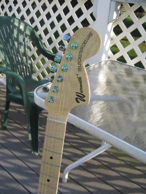

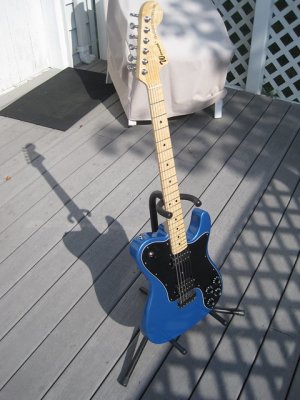

I don't have a photo handy, but I put a waterslide decal on my Telecaster Deluxe and top coated it with some shellac. Fast drying, pretty harmless, did a few coats over maybe an hour, letting the dry in between, and never gave it a second thought again! It's held up great, but I haven't put the Tele through anything too traumatic.

Here's my Telecaster Deluxe. Like I said, a few coats of Shellac and it's been fine! I could have sanded the Shellac to a smoother finish to match the satin neck, but it was barely noticeable
