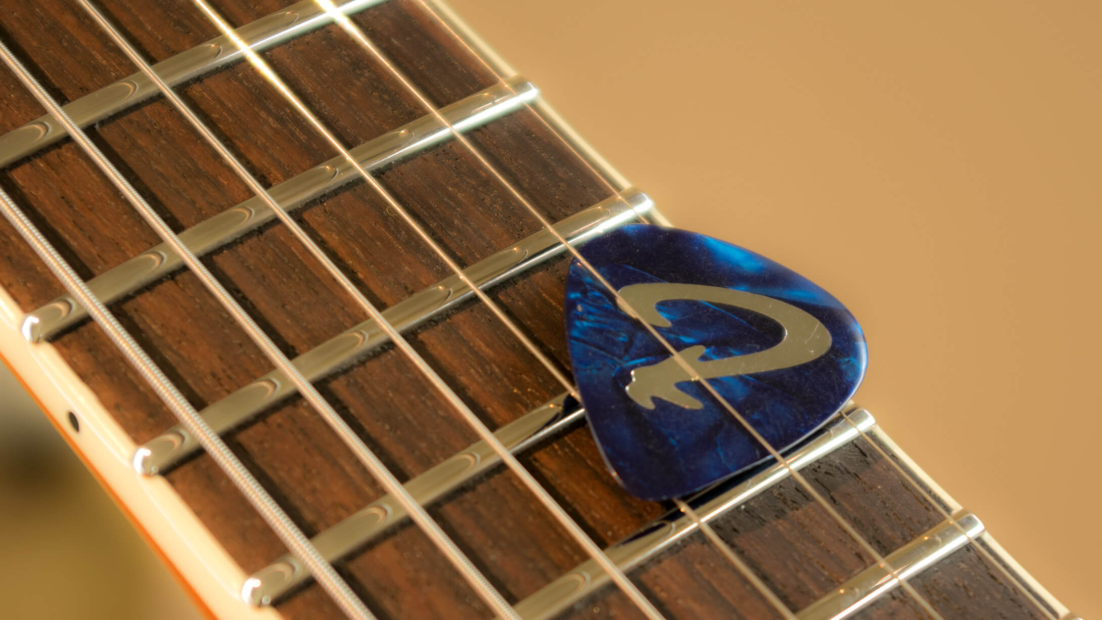

1 : with this closeup photo, compared to a factory made guitar ( PRS SE ) I sure not remove too much.
2 : did you watch to the end of the video? I talked about Warmoth increasing the back-bevels the fret edges to about 30° recently. that leaves not much room for you to do If people need to round fret end dressing, if you want to do what I show in the video, need to ask Warmoth don’t bevel it and not buy showcases neck with frets installed already.
3 : I will be made a follow-up a video on what I have done for the 30° back-bevels the fret edges when I have time, it removes much less on frets end.
4 : what I trying to illustrate there was a technique I believe useful for other DIYer, how much to remove is a personal preference with his playing style.
5 : like all DIY project, I recommend people measure twice and cut once, make sure you know your personal preference, look the other guitar you comfortable with your playing style, how much roundness on that fret end .

Per the PRS comparison photo. Note on the PRS the lie of the strings, there is still quite a bit of space between the E strings and the slope of the end dressing, meaning there is still enough playing surface. On a Strat or Tele, the playing surface would be too reduced.
@Hendrix, alas this is not one of the top ten inventions that changed the world.
Perhaps refine the technique to have less of a slope and leave a proper playing surface.
@Aircap, yes I agree he is removing too much material.
