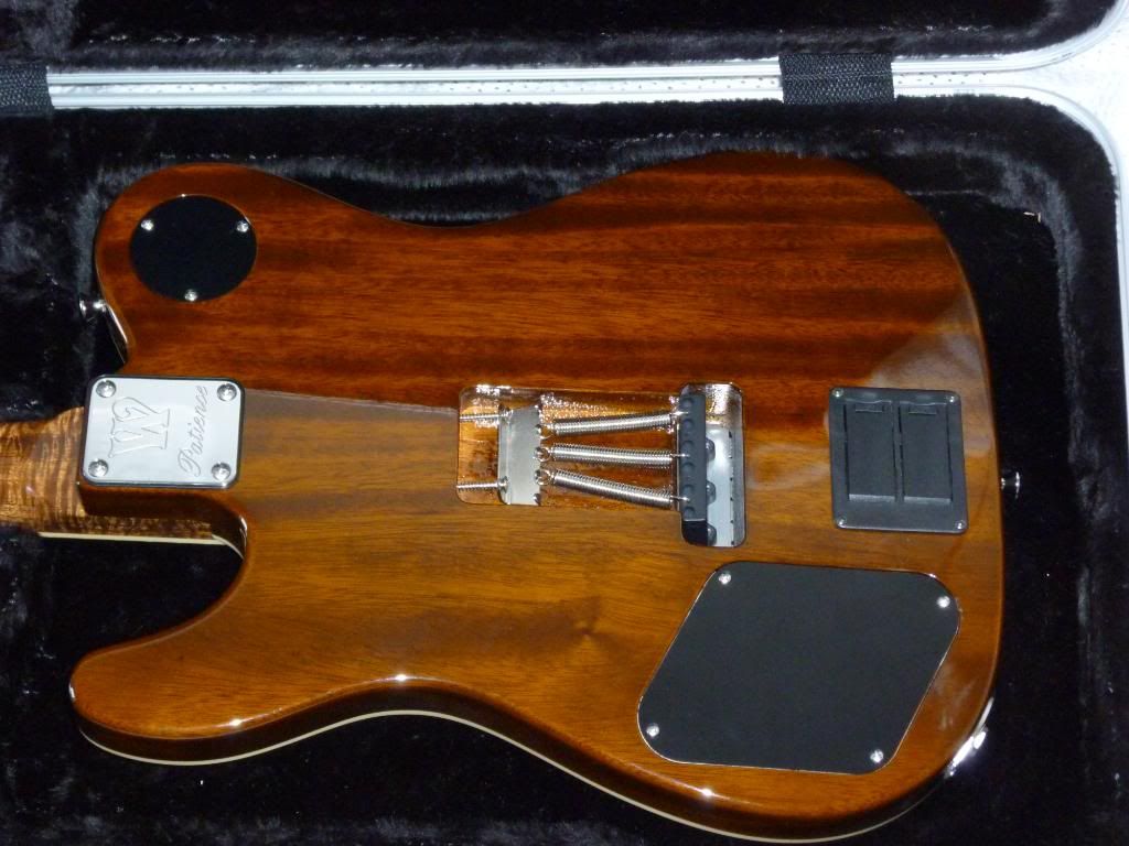

Been on hols and able to get stuck into some long overdue work on guitar projects. Have started putting this one together, in dedication to our Forumite friend on here, Death by Uberschall who - when I was contemplating the purchase of the neck & body, had a lot of his gear stolen. Hence the name "Uber Tele".....
Story behind this project is of having some expensive quality EMG pickups and EQ pots that I tried to install into a Jazzmaster project (my infamous "Jazzmonster" project). Simply put, the EMGs wouldn't fit due to the tight cavities within the JM standard routing, and well, it seemed like I was trying too much.

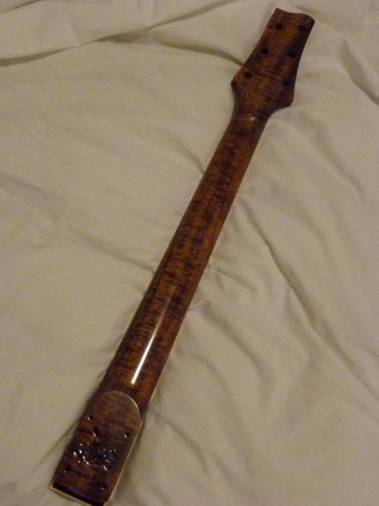

A few months back the neck was up on the Showcase and it really got me thinking......mmmm Flamed Koa would be nice tonally, but Ebony - bit bright for the EMGs - I dunno? Then I thought 'what the hell', and snapped it up after it had been on Showcase for a while. Body was then ordered to fit in with the quality of that neck, a one piece mahogany body (solid) finished in Trans. Brown with a Unique Choice Quilt top done in Tigers Eye Dye.
Heres' the specs
NECK:
25.5 " scale
Flame Koa neck
Ebony Fretboard
MOP inlays
Ivoroid neck binding
1 11/16" neck width
Corian nut.pre installed
Planet Waves self trimming tuners
Terrapin Truss Rod Cover "Warmoth Uber Tele"
Clear gloss finish.
BODY:
One piece Mahogany solid construction
Unique Choice Quilt Maple top (carved top)
Mahiogany finished in Transparent Brown
Quilt Maple finished in Tigers Eye Dye.
Humbucker - X - Humbucker rout
Upper toggle switch
LP control layout
Double Battery box rout
VS100 Wilkinson recessed rout
Ivoroid binding on top
Strat neck pocket
Dangerous R6 custom neck plate "Patience"
Electronics:
1 X EMG 89 dual sound humbucker
1 x EMG 89R dual sound humbucker (neck position)
Volume - Volume - EMG SPC - EMG EXG
3 way toggle.
While this would appear to be a very much completed poroject that is not the case...... The electronics are a nightmare!
Because I had owned these EMG 89s for some time, they are the older soldered style of pickup yet EMG have now switched over to a solderless system.
My suggestion to anyone thinking of mixing and matching a solderless system and the older style soldered joints is DON'T. Too much adaption and cutting and soldering in to achieve the end result. Best to go one way or the other.
I DO have about 50 wires snuck into that rear control cavity. Hauling the 6-in-1 EMG89 wires AND the 4 toggle switch wires through the routing for wiring underneath the neck position was - how should we say this? - a 'challenge'.
Also I would advise against buying the solderless long shafted pots with the DPDT switch attached from EMG IF you are doing a CT Tele project, they are too tall to fit in. I have had to adapt an old pair of long shaft DPDT/Pots and they fit, but the soldering was not successful and I am waiting on parts from EMG to try and implement a solderless pot there (short shafted DPDT/Pot).
Other pix at:
http://i835.photobucket.com/albums/zz274/ozziepete_2009/UberTele%20Project/P1000207.jpg
http://i835.photobucket.com/albums/zz274/ozziepete_2009/UberTele%20Project/P1000205.jpg
http://i835.photobucket.com/albums/zz274/ozziepete_2009/UberTele%20Project/P1000206.jpg
http://i835.photobucket.com/albums/zz274/ozziepete_2009/UberTele%20Project/P1000208.jpg
http://i835.photobucket.com/albums/zz274/ozziepete_2009/UberTele%20Project/FlameKoahead.jpg
http://i835.photobucket.com/albums/zz274/ozziepete_2009/UberTele%20Project/FlameKoa.jpg
