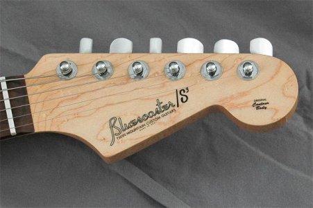

Resurrecting an old thread here, but I was wondering if you might consider sharing your file for this headstock logo? I think it's brilliant, and I've always liked the idea of having a logo on my Warmoth Pbass, but never wanted to stick a Fender one on there.
Awesome, thanks! I really do love the Fender-font Warmoth logo. It clearly says Warmoth, so it's not trying to fool anyone, but maintains the design aesthetic of the original instrument.
If deejaysham doesn't respond (or not positively), and nobody else jumps in, I could put one together for you.
A couple of other sources:
J Bennett-
http://bennettdecals.wixsite.com/decals
He does a nice Fender script. I sometimes had a little trouble getting my ideas across, but it worked out nicely in the end. (The "B" character is really a German Sharfen S. That's the part that took a lot of going back and forth to get right. His "B" was very nice, but not what I wanted.)
=or=

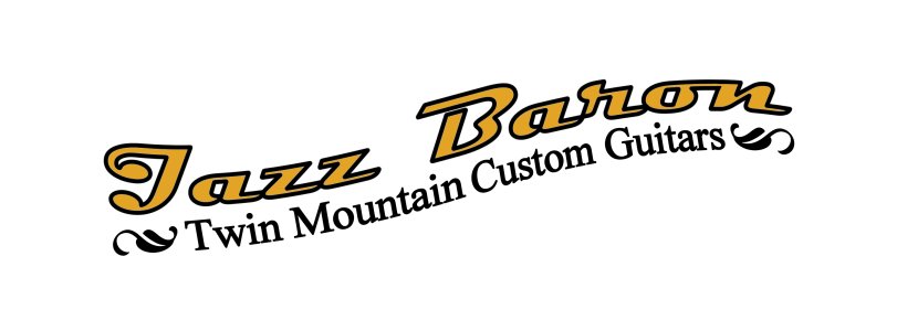

Rothco & Frost-
http://www.rothkoandfrost.com/custom-waterslide-decals-uk-for-guitars-bikes/
I used them for my new build. Sent them my own design, and they did an EXCELLENT job!
Good luck!
Pics attached: (1) Bluescaster" decal made by J Bennett. He uses the gold paint method mentioned in the OP. (2) I don't have a photo of the "Jazz Baron" decal as it isn't mounted yet, but this is the design I sent Rothco & Frost. The gold is metallic ink and looks really nice.
