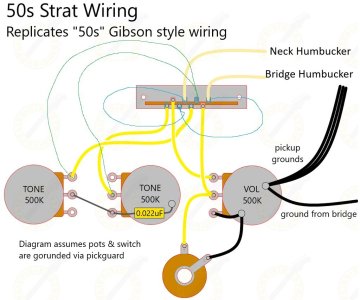

So I have this Swamp-Ash Strat Warmoth Body with H-H, so just dual humbuckers with no Single in the middle and a 3-way selector switch.
I figured giving 50s wiring a try, so got the attached wiring diagram and followed everything.
Now all seems to be working fine except the middle position on the 3-way selector switch: there is no sound at all, while I should get Neck and Bridge humbuckers combined.
Any idea what I need to change?
