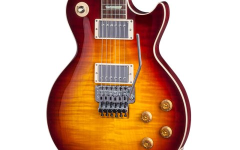

I have seen that "BFG" with the tremolo. Also ESP makes some LP style guitars with a tremolo bridge.
Gibson recently (2017) has/had a limited run of the Axcess LP with a Floyd Rose and there is/was a Alex Lifeson model. The body has been cut-up and contoured. They go for over $4000. I've read good things about them but you never know how much is hype.
After my 1st Warmoth build, I've been so happy with it (after all my tweaking), I told myself I'd probably never buy another guitar from a guitar shop.
