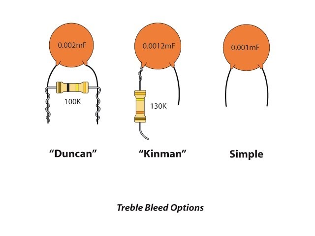

You need to also learn about the Kinman series treble bleed. ;)
Googling for the treble bleed of the man and his kin ("kinman treble bleed") led to an interesting article:
https://www.seymourduncan.com/blog/latest-updates/3-popular-treble-bleed-mods-what-you-need-to-know

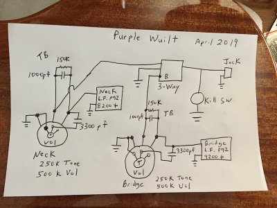

Maybe I will use the kinman variant on my purple guitar and the prs/simple/cap only variant on the 7/8 S-Style.
