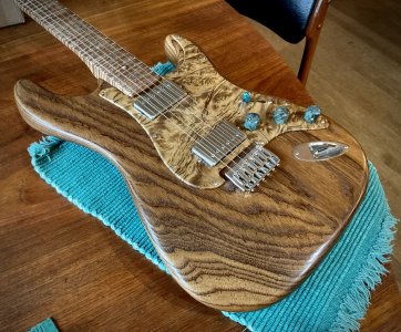

This might be the prettiest Strat I've seen...
Thanks!
Roasted neck and body for sure. So you guys think that's oil, no grain filler, and lots of buffing?
No hard finish coat? No lacquer?
I've done Tung oil and it never got that dark. Does Tru Oil? Never used it.

Watched a video from Warmoth about roasted swamp ash and how dark it gets with just multiple coats of clear sanding sealer. No stain. No oil.
I do want to build one that looks like the Strat in the photo in post #1 and do it in oil if that's how to achieve that look.
A little internet sleuthing has me feeling pretty sharp eyed....
The Percoco Custom Shop proudly introduces the Model 1918 "Frank". Classically inspired by Mario's own family roots. A one piece aged and roasted swamp ash body paired with a roasted maple neck and fingerboard provide an incredible amount of resonance, clarity and sustain. The hand rubbed oil finish retains the woods natural vintage look, amazing feel and woody tone.
Danish Oil and Tru Oil are both hard drying since they have resin varnish in them.
  • Danish Oil is a equal mix of 1 part varnish, 1 part boiled linseed oil, 1 part thinner. It is considered a penetrating oil
  • Birchwood-Casey Tru Oil is 3 parts varnish, 1 part linseed oil, 4 parts thinner, so it dries faster and harder of the two. It is not a penetrating oil. It's "on label" use is for gun stocks
  • Tung Oil contains no resin, it's just tung oil that we thin 50/50. It's a drying oil, but it doesn't harden
G&L uses Tru Oil on their "gun oil" necks.. Fender Custom Shop and Musikraft use danish oil on their oil-finished necks. Warmoth says, "All our necks are dipped in an oil based penetrating sealer which is compatible with virtually all secondary finishes. This provides enhanced stability; however, it is not adequate protection for playing."
As you mentioned, roasted swamp ash turns a dark walnut color when coated.

Polymerized Tung Oil does set up hard, and takes a nice polish; got it from Veritas. This guitar body and pickguard has 10-12 applications. After initial drying and wiping of excess oil I put it over a 25W dehumidifier/heater(Sta-Dri) for a day before sanding and reapplying. Good thing about it is absolutely no toxic solvents or other additives.
As corrected by Stratomania; Polymerized tung oil from Veritas(Lee Valley) is 50% mineral spirits. So it does emit toxic fumes including toluene, benzene, xylene and other cyclic and long-chain hydrocarbons. Good idea to use a carbon filter mask when using. Also means you’re only getting half as much actual tung oil in the can.
That's an eye-poppingly beautiful instrument! (y) (y) (y) (y) (y) (y)
