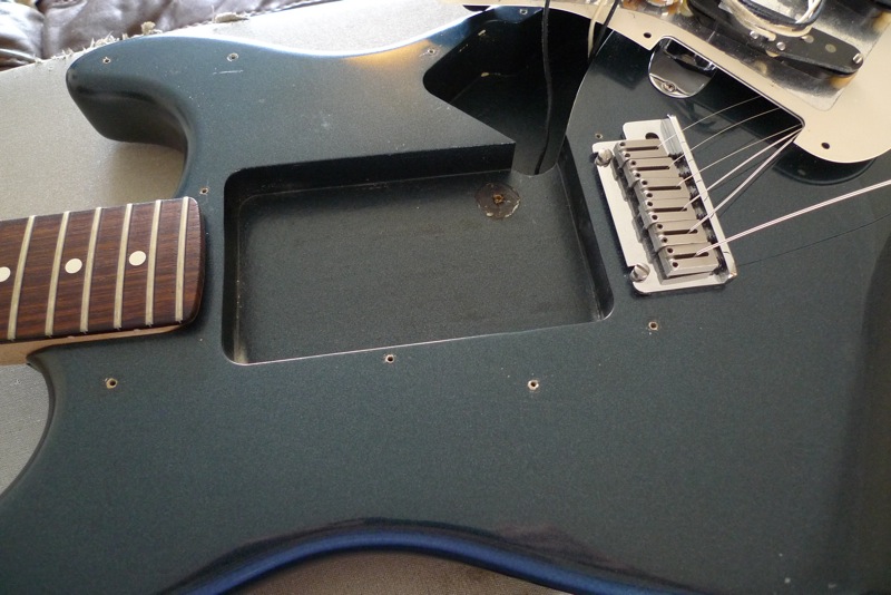

In other words, the area under the pickguard is pretty wide open, so you can install just about any pickup combination/type you want for starters, and if you want to change it later it's a simple matter of getting another pickguard. This also allows you to change the number and position of controls such as volume, tone, pickup switches, etc. I know you said you don't necessarily want a pickguard, but in your case the utility may be too much to ignore. Besides, we're talking Strat. Strats usually have pickguards. Unless you're buying into a highly figured top that you don't want to cover, a pickguard is a Good Thing. Plus, even if you do have a fancy top, the lack of a guard means your pick and fingernails will destroy it.
