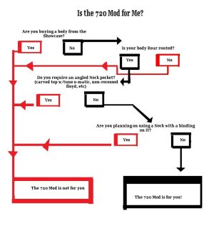

It isn't a neck option, it's a body option.  Somehow the 720 mod has created confusion where I see none.
I have included my flowchart I (crudely) made many moons ago.
You cannot 720 mod a body if:
you're buying a showcase body
you're needing an angled neck pocket (TOMs, bodymount (non-recessed) floyds)
you're using a pickguard
you're going to use a neck w/binding
*edit* I made the flowchart Feb 24 2010, so that must've been about the time that the option was first available

To answer your specific question, the 720 mod is really a fit and finish kind of thing. It's to get rid of that overhang where the pickguard would be under the fingerboard extension on a top-routed strat/tele/etc. It makes no difference in tone whatsoever (okay, maybe to Eric Johnson, but no one else would hear it). The only possible playability improvement is that it makes the overall thickness of the neck joint just less than 1/10" thinner, which could conceivably make it easier to play up high, but a countoured heel is cheaper and more effective at that, so......
On another note, you actually could use a 21 fret neck with the 720 mod and a pickguard as there's no fretboard overhang to cause problems with the pickguard. I guess you could also deepen the neck pocket area of the pickguard to remove the part that would fit under the extension if you really wanted to. But regardless, W won't do it on a top-route body, so you'd have to do it yourself in that case.

It is a visual thing and would not have any advantage in playability or tone aspects of the guitar. The above flow chart highlights the dos and don'ts of the mod very well ( and credit to whoever set that up as it will solve a lot of "what-ifs...?"  :icon_thumright: ).
