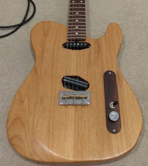

A lot of it is the pickup. There is a steel base plate under tele bridge pickup that changes the tone dramatically. I mounted the pickup directly to the body, hot rail humbucker tele pickup. Still has a nice fat twang.  :toothy10:

This is my favorite tele config. My first partscaster based on GE Smith Tele with some modifications.  :icon_thumright:
