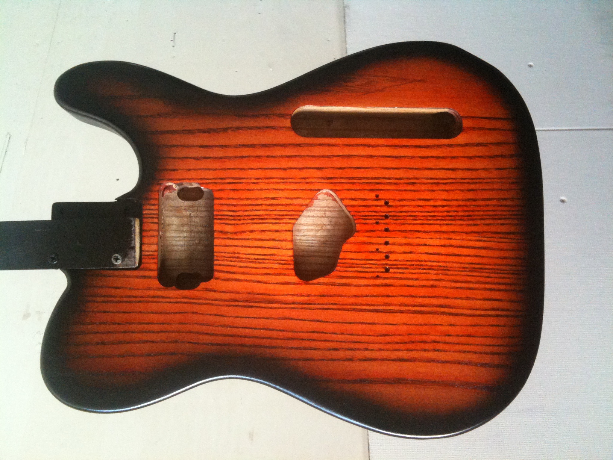

I have a Warmoth Tele originally routed for a neck position humbucker.  I later retrofitted a Strat pickup in the neck position and required extra routing.
There's several picks on the first page.  Here's the thread:
http://unofficialwarmoth.com/index.php?topic=21559.0
Not sure I'm following you.
This was a showcase body, with a tele route.
Re-routed for humbuckers, with a tele neck route.
I didn't have to do anything special to fit pickup ring.  :dontknow:
