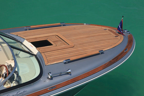

Also the preferred decking material of the high-end powerboat crowd, i.e., yer vintage ChrisCrafts:
