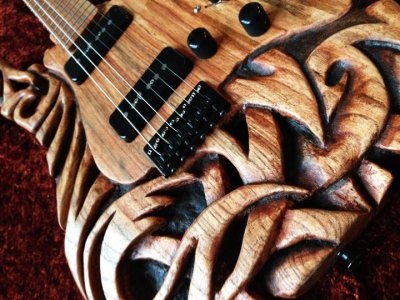

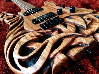

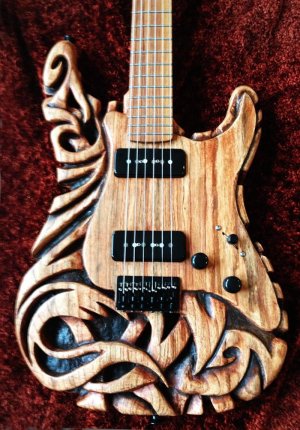

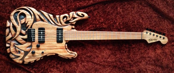

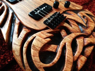

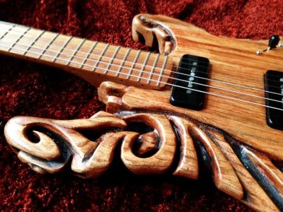

I'm new to the forum (I didn't know it existed) but I've got a bunch of Warmoth builds I'll be posting in the next few weeks. The first one is my most recent creation. I call it the Tattocaster because part of the design is based on a tattoo I got 20-something years ago.
It's a Warmoth alder body, rear-mount controls. I carved a faux "pickguard" into the body, but it's just an illusion. The neck is a Warmoth canary on canary, 1-11/16" standard thin with a compound radius. I hand-stained the body to match the grain and color of the fretboard.
Pickups are Lindy Fralin hum-cancelling P90s. It's a hardtail bridge, and Hipshot locking tuners.
This took about 50 hours, and I loved every minute of it.

One thing I would do different: I always get no fret markers on the neck; just the side dots. Normally it's not a problem, but this is my first canary neck. There isn't very much contrast between the color of the neck and the little black side dots, so I had to put little drops of white paint on top of them to see in stage lighting. Not a big deal, but next time I'll get white markers!
Blow down the walls and take no prisoners, huh? Fantastic work! If you need dots, there's a casting epoxy product called Milliput:
http://www.milliput.com/
It comes in two little logs inside a box, you cut off equal sized gobs of each then squeeze them together over and over until it's completely mixed - five minutes - then you have about 20 minutes to work with the stuff. So you drill your side dot holes, then mix it up, stuff it in, and wait four hours. It does shrink a little bit, so you can overstuffed, or drop fill it with super glue.. But there's not really an issue of "spilling" on anything, it's scrapes or lifts right off once it dries. I'm really surprised nobody else knows about it...
