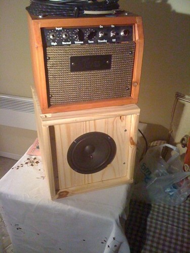

I'm now in the process (long process) of building a bolt on for the front of a 6inch Jensen speaker cab I made for my Torres Tiny Tone 1.5W tube amp kit.  The cab I made from pine dove-tailed.
The bolt on will attach to teh front of the cab be air-tight, and simply be a piece of pine with a 6inch hole cut in it, with a funnel over the top of that.  That will funnel the sound up a tube and into my mouth.
I just wanted an all tube talkbox with a real speaker instaed of a compression driver.  Just a fun project I fancied doing.  Havent had the time recently though  ???
wow that sounds like an awesome idea jim  :icon_thumright: a tube talkbox, who woulda thought!
