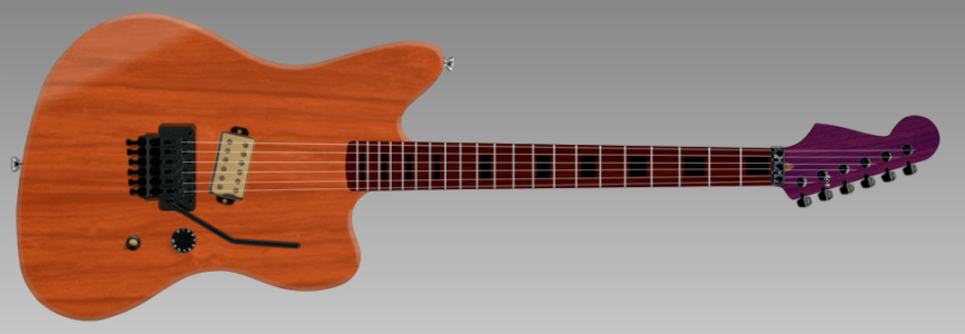

J jackastro Junior Member Messages 39 Feb 18, 2023 #1 New project is a Jazzmaster body with superstrat functionality. This is the kisekae prototype. Last edited: Feb 21, 2023

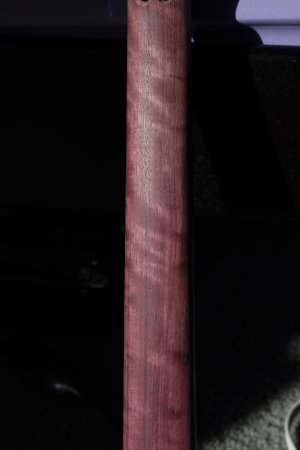

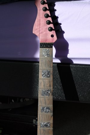

J jackastro Junior Member Messages 39 Feb 18, 2023 #2 Warhead neck. Ziricote over Purpleheart. Wizard profile. Last edited: Feb 21, 2023

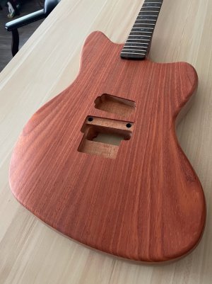

J jackastro Junior Member Messages 39 Feb 18, 2023 #3 Mahogany body with a Padouk top. Chambered construction. Last edited: Feb 21, 2023
S Spud Guest Feb 18, 2023 #4 jackastro said: New project is a Jazzmaster body with superstrat functionality. This is the kisekae prototype. Click to expand... It looks really nice. Uh oh, they forgot the neck pickup route for cryin' out loud!

S Spud Guest Feb 18, 2023 #5 jackastro said: Warhead neck. Ziricote over Purpleheart. Wizard profile. Click to expand... Oh geez! They only sent 5 tuners too! What is going on!!

bruzanhd Senior Member Messages 217 Feb 18, 2023 #6 Very cool, will you be adding a finish to the body?

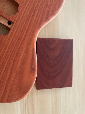

J jackastro Junior Member Messages 39 Feb 19, 2023 #7 bruzanhd said: Very cool, will you be adding a finish to the body? Click to expand... I tested Danish Oil on a piece of Padouk and let it age for a year. One flood coat and two slurry coats. I plan to finish the body the same way. The finish is really silky smooth, but still has a porous, woody texture. I really like it. Last edited: Feb 21, 2023
