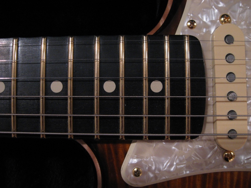

I bought a neck from Warmoth about 4 years ago with a 1 11/16" (43mm) Earvana nut that went on a guitar with a Wilkinson VS100 vibrato bridge that measures out at 2 1/8" (54mm) string spacing. A quick peek with the caliper says I've got about 3mm of useful fret on the outsides of the low/high E strings pretty much the entire length of the neck. I can't really imagine wanting more than that. Thing plays like a dream.

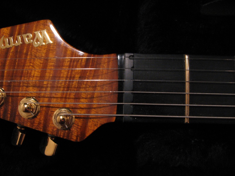

Incidentally, Warmoth cuts their nut slots quite well so you don't need string trees, but they are a little shallow because they don't know what the end user is going to be comfortable with. So, if you're picky at all, you may find you'll have to take the thing somewhere for setup.

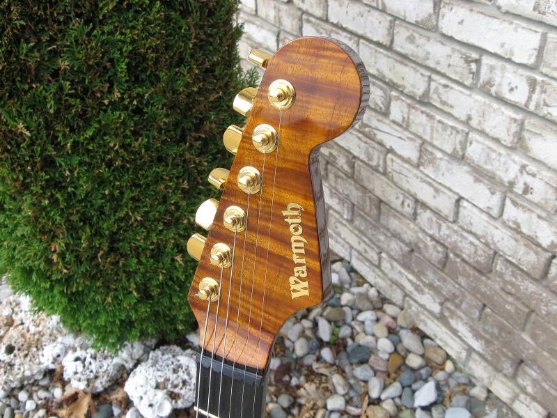

Here are a couple shots (please forgive the quality) of the guitar I mentioned above, so you can sorta see the distribution...
Do you have more pics of this particular guitar, Cagey? From what I can see in those two pics, it looks really nice.
Unfortunately, my photo files are pretty disorganized, but here are a few older ones I could find...
The body is a chambered piece of Swamp Ash topped with the figured maple you see. Wilkinson VS100 vibrato, Dimarzio Area 58, Area 61 and Fast Track pickups. The neck is black Ebony over Koa, with a curly Koa laminate on the face of the headstock. Schaller mini-lockers, Graphtech Earvana nut, gold 6100 frets, vintage tint gloss poly finish.
