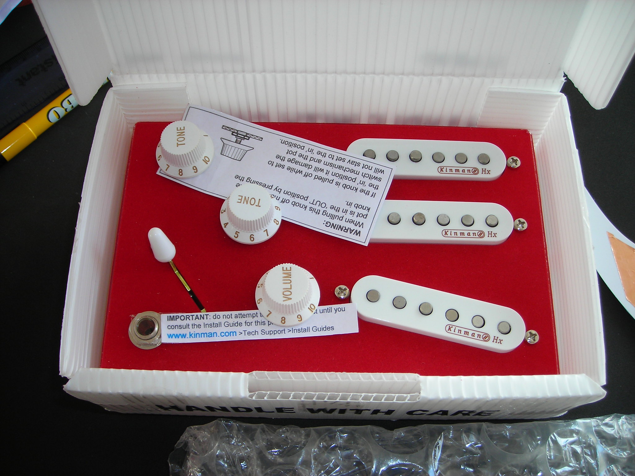

Here is a set of Kinmans for reference.
Pickups Screening3 by stratamania, on Flickr
And showing how they align. The polepiece width of each pickup varies from one to the other to take into account the taper of the strings.
