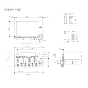

Please stock the narrow 510 trem
I agree on this.
I'm actually ordering this exact trem for the body I just bought.
If you buy one from somewhere else it will fit the 510 rout.
Just to point out but the difference between the NS510s and the others is 10.5mm spacing versus 10.8mm. The difference is 0.3mm.
This is very different from the difference between a vintage 6 screw strat and a modern one. You won't get strings slipping off the edge of the board with the 510 trems.
