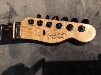

I used the Nitrocellulose Lacquer product from Stewart McDonald called "Colortone Guitar Lacquer" and it worked great.  I sprayed about 8 thin coats over the decal and waited a few weeks.  Then I wet sanded it down and it turned out where you could not even feel any raised lip of where the decal was applied.  Check it out!
