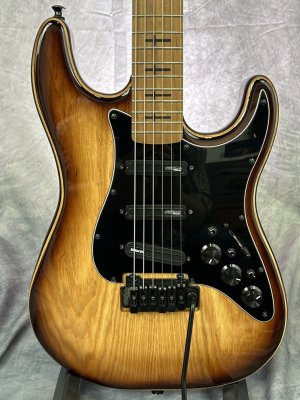

First build, learned a lot (mostly from the outstanding community posts here and Aaron's videos) , had a bunch of fun.
I'm on the short side and getting a little older. I've looked around for something shorter and lighter but could never find anything that felt just right so figured I'd take a lash at a short scale partscaster. Closest I ever got was a friend's Mustang; but I'm not fan of its twang bar.
The SkunkCaster required a bit of fret finagling and nut work as would be expected; slightly rolled the edges of the fretboard. I was planning on burnishing the neck per Aaron's awesome video but decided it didn't need it. It feels great, better than the 30+ years worth of wear on my 94 Carvin (which I still dig).
I hacked up the pickguard to add a 6-pos rotary switch for variable cap values on the tone pot, three 3-way toggles for parallel/split/series on the pick-ups, and a V-Treb in the trem cavity. It was a bit tight but fits OK. I'm normally a simple guy and appreciate the one volume control setups but I wanted some variety.

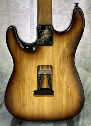

BODY - 7/8
Construction - Chambered
Core Wood - Swamp Ash
Lam Top Wood - Swamp Ash
Right/Left Handed - Right-Handed
Control Cavity - Top Rout
Multi Pickup Top Rout - Universal
Jack Rout - 7/8" (22mm) Side Jack Hole
Bridge Rout Type - Tremolo
Bridge Rout - Wilkinson Semi-Recessed
Would you like Warmoth to install the bridge studs? - Yes, from a bridge I have on order
Mounting Holes - Standard 4-Bolt
Neck Pocket Shape - Strat®
Body Contours - Forearm Contour, Tummy Cut, Custom Contoured Heel
Binding and Edge Decorations - Natural Masked Edges
Battery Box - None
Paint Category - Burst
Top Color - Brown to Clear Burst
Back Color - Brown to Clear Burst
Satin or Gloss - Gloss

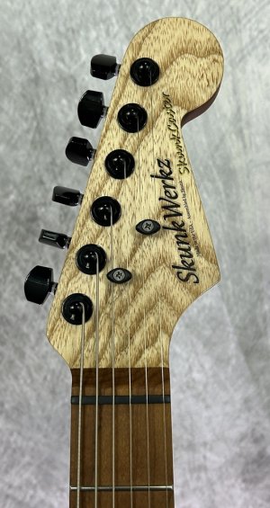

NECK - Mustang/Jaguar
Construction - Modern
Shaft Wood - Roasted Maple
Fretboard Wood - Roasted Maple
Nut Width - 1-11/16" (43mm) - Modern Medium
Neck Back Profile - Wizard
Fretboard Radius - Straight 12"
Number of Frets - 22
Binding - None
Fret Size & Material - SS6105 - Narrow & Tall (.095" X .047" Stainless)
Tuner Hole Size - Planet Waves (13/32"; 10MM)
Inlay Shape - Straight Cross
Inlay Material - Black
Side Dots - Black Side Dots
String Nut - Standard Nut - GraphTech Black TUSQ XL
Neck Heel Shape - Strat® Shape
Headstock - Swamp Ash Peghead Veneer - Match Body
Finish - None
PICKUPS
Bridge = DiMarzio Fast Track 2
Middle = Wilkinson MSeries 7.2K (B0C537G5K5)
Neck = Wilkinson MSeries 7.2K (B0C538SBWC)
TUNERS = Hipshot 6K1EL0B-STAG
BRIDGE = Wilkinson VS100B
Weight = 7.110 lbs
