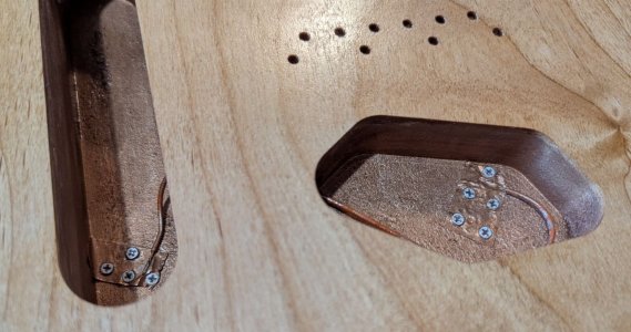

You can paint the pickup cavities with shielding paint, run a wire between the pickup cavity/control cavity, and use a small screw to ground it to the shielding paint
Personally I don't think shielding the pickup cavity is all that necessary/useful, particularly with humbuckers or otherwise hum-canceling pickups

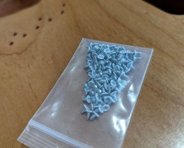

I recently did shielding paint in my Esquire cavities, then tried soldering the cavity-jumper-wire to a little piece of adhesive copper tape, but subsequent paint melted the foil adhesive. Found some ultra tiny screws on Amazon and now its nicely fastened down and conductivity is good.
( https://www.amazon.ca/dp/B0C6QVP2FL )
