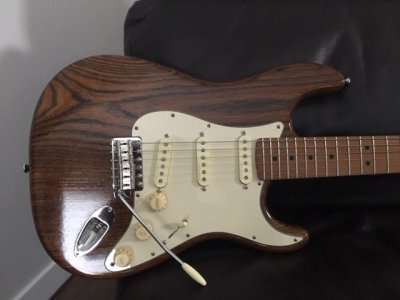

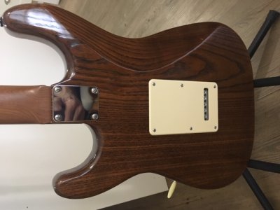

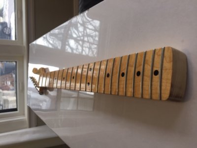

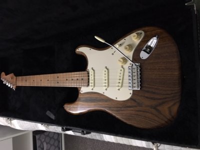

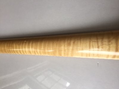

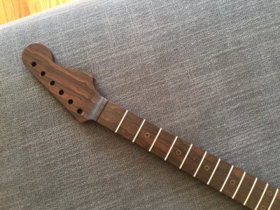

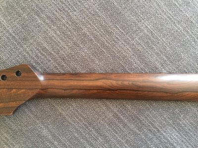

Thanks to all of you for being so helpful, I've got it done, guitar sounds great and am real happy with this build, a few pics below. Starting on a new build in January, another Strat, I will be making a chambered body out of torified bamboo, hope I can handle it. I was lucky to find a retiring luthier (real nice guy) who was selling off some of the necks that he had made in his last couple of years, a flame maple Strat neck, jumbo frets including Vintage Gotoh tuners, a Tele neck made of Honduran mahogany and Indian rosewood, Gotoh vintage tuners and jumbo frets, both are like new only used a few hours on his own guitars, he sold me both for the equivalent of $200.00 USD. He also has a new solid Ziricote Strat neck that he has offered to me for the equivalent of 290.00 USD. He says that they are kinda rare, as I am not familiar with this wood I would really appreciate your opinions on whether it is worth buying. Please let me know your thoughts. Didn't think I could go wrong by buying the maple and mahogany necks but definitely no sure about the ziricote neck, although it is gorgeous pics below
Regards to all
Maurice

Here is some information on Ziricote.
https://www.warmoth.com/Guitar/Necks/NeckWoods.aspx#Ziricote

Also, don't eat Ziricote. It's eye candy, not mouth candy. Besides, like my cardiologist says "If it tastes good, SPIT IT OUT!" :icon_biggrin:
